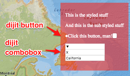

Now I want to add dijits to my widget: comboboxes, buttons, stuff. Styling is pretty intense and best handled someplace other than inline. Also, the css is available via CDN from dojo and ArcGIS.
When I compile the TypeScript below and drop it into my map app, the styling is, well, primitive. (Sorry, no jsbin).
Any clues on how to start building more complex and styled widgets that I can add to my map apps would be greatly appreciated. TIA
THE RESULT:
