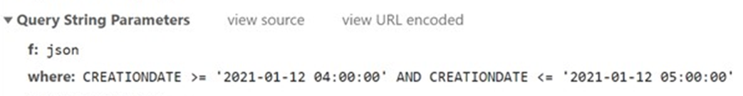

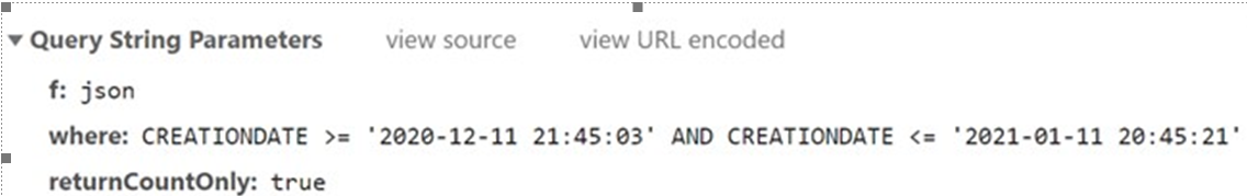

We have a survey published to client's ArcGIS Enterprise 10.51 and its overview tab https://survey123.arcgis.com/surveys/[itemID]/overview is failing to load. When I check the query requests, it looks like it's querying the creation date field in daily interval until it reaches the current time. In our test environment, where the same overview tab works fine, this is the last query request (today is Jan 11th, 2021)
With the problematic overview tab, I see the last few query requests' where statement is querying tomorrow's date. Can this be the culprit of why the overview tab is failing to load and freezes the browser? I asked the client to check the time zone of the editor tracking fields as well as the server machine's clock.
