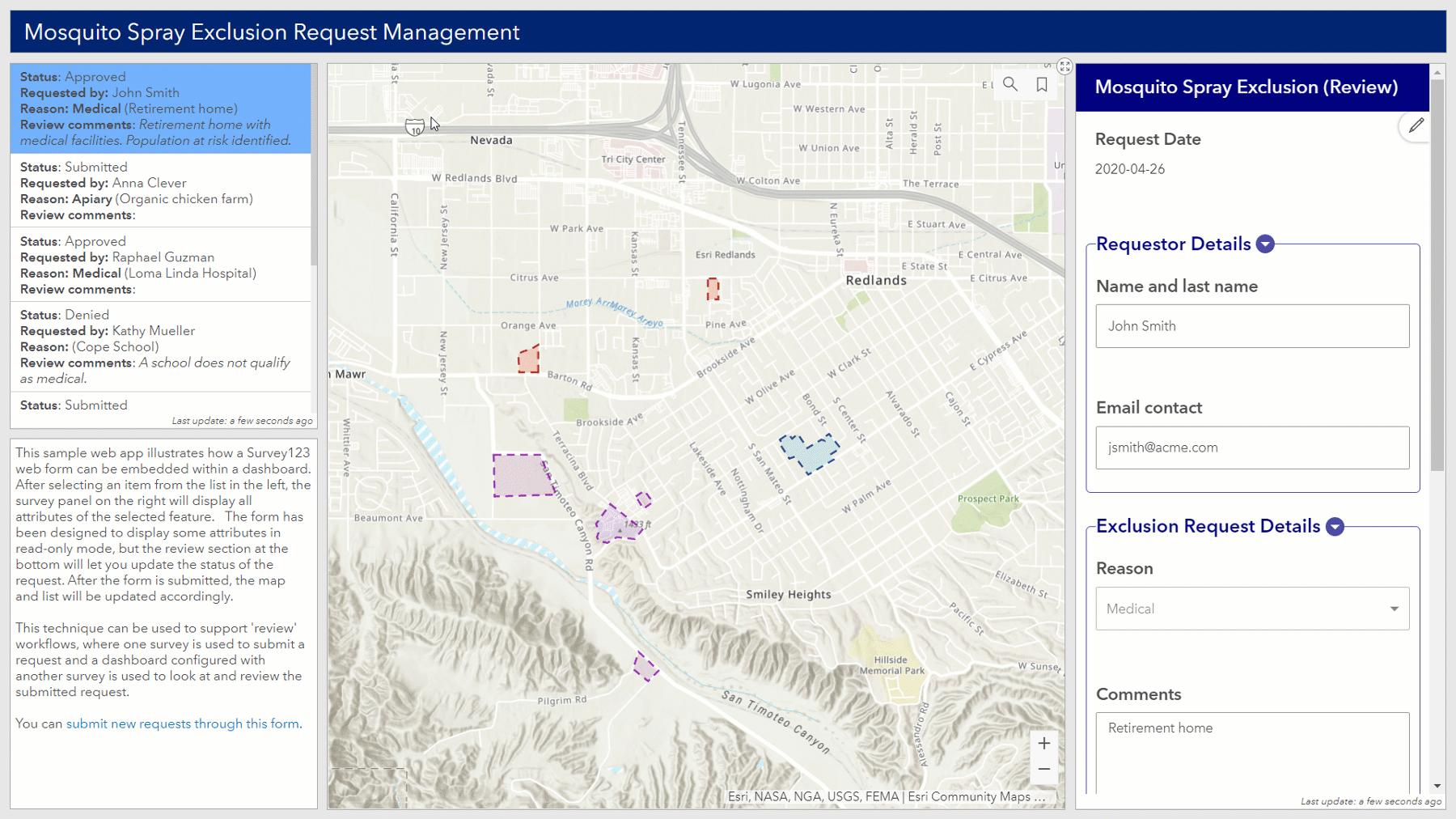

In this post you will find step by step instructions to help you embed a survey within an ArcGIS Dashboard. This is a commonly used used to support QA/QC and review workflows. The animation below illustrates what this could look like. In this dashboard, a list of mosquito spray exclusion requests is shown in the left panel. These requests are added through a separate online survey open to the public. A request review survey has been embedded in the right panel. As requests from the list are selected, the survey is automatically populated so the request can be reviewed and updated.
The above example provides a compact user experience for browsing and updating existing data. This same idea can be applied to many workflows, where one survey is used to submit jobs or requests of some sort, and a dashboard with an embedded survey is used to review the incoming information.

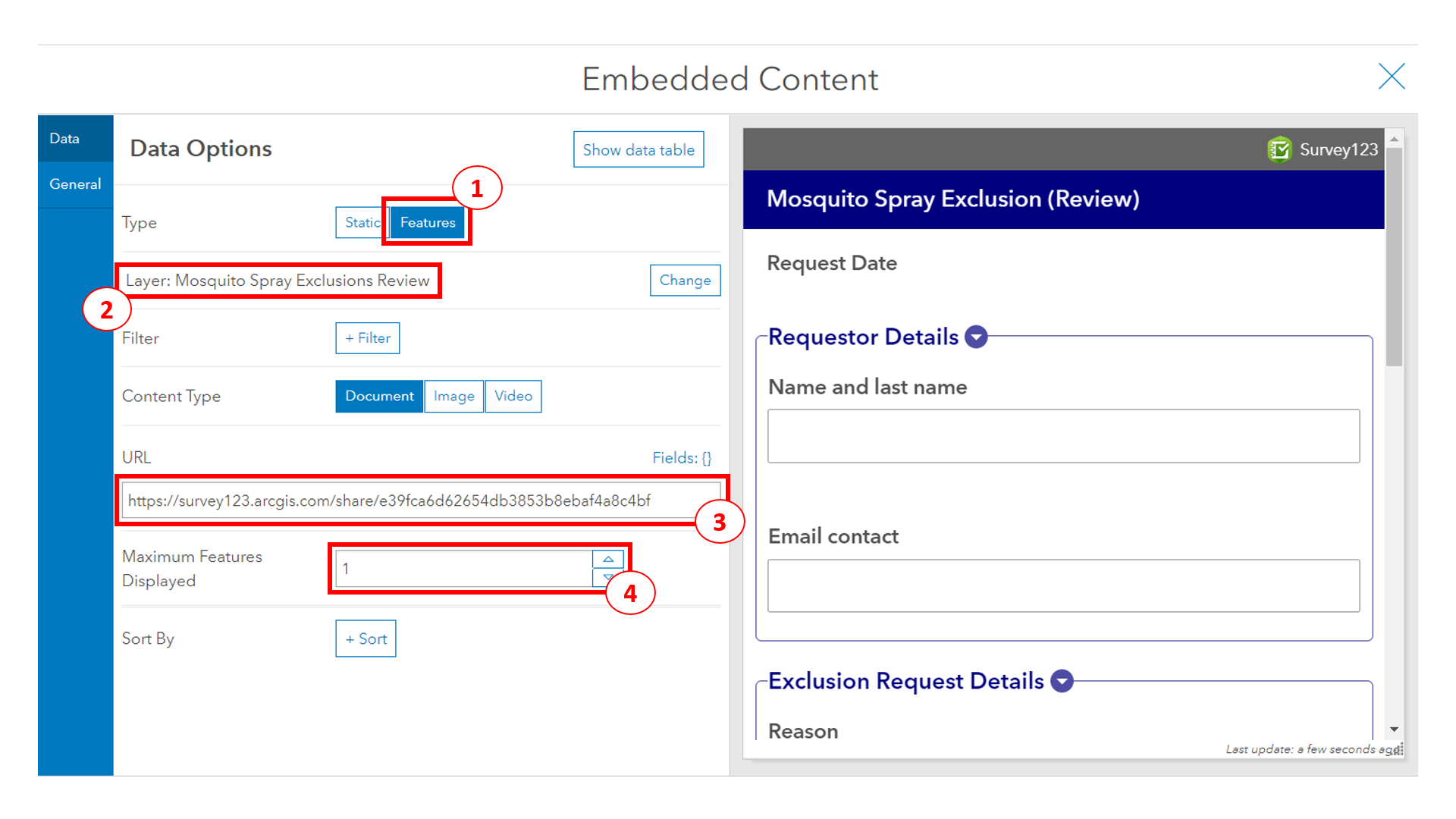

- Next, add an Embedded Content element.

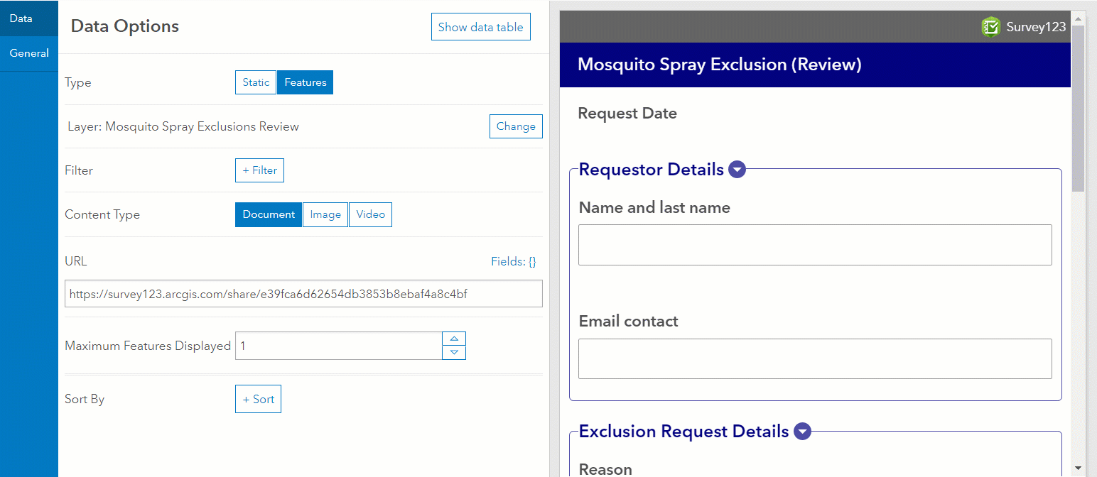

- In the Data Options panel, first set the Type to Features and target your survey feature layer.
- Paste the URL of your survey web form into the URL property.
- Set the Maximum Features Displayed property to 1.
At this moment, a preview of your survey should be shown in the right panel. Next, we are going to modify the URL with some extra parameters to load content and adjust the look and feel. If you are not familiar with the Survey123 web app parameters, check out https://community.esri.com/groups/survey123/blog/2019/02/06/survey123-tricks-of-the-trade-web-form-url-parameters and https://community.esri.com/groups/survey123/blog/2019/05/24/survey123-tricks-of-the-trade-editing-records-in-a-web-form

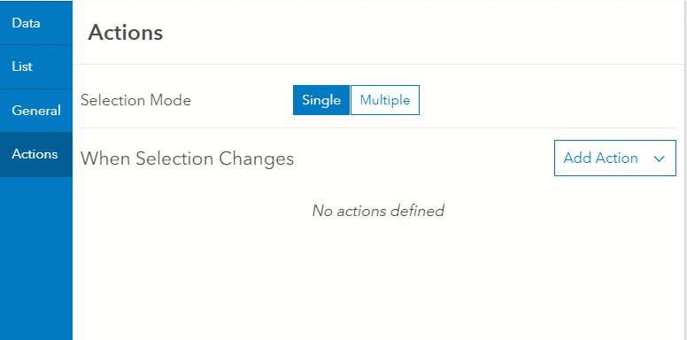

At this moment you have the List, Map and Embedded Content elements in your dashboard, but they do not talk to each other. We are going to configure actions to make them work together.
- Open the List element configuration dialog and add a new filter action targeting the Embedded Content element
- Optionally, you can also configure actions in the List element to zoom to and flash the selected record.

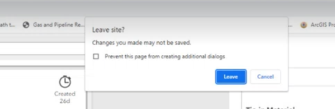

If you get a "Leave site?" dialog every time you try to load a new survey into your dashhoard, add leaveDialog into the hide parameter of your survey url. For example, from &hide=footer,navbar to &hide=footer,navbar,leaveDialog
