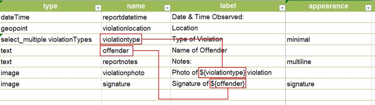

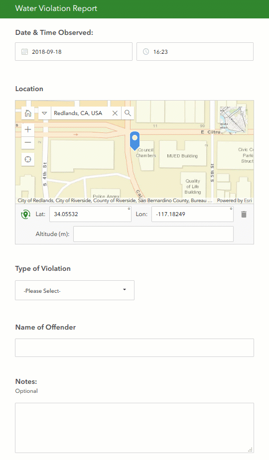

The Water Violation survey sample on the side, for example, shows how you can insert the Type of Violation and Name of Offender in the photo and signature questions that follow.

In order to insert text dynamically within a question label, you must add XLSForm variables in the label column of your survey. The syntax is quite simple. Insert ${QuestionName} exactly where you want the answer to a particular question in the survey to appear in your label. This is what the Water Violation example illustrated above looks like in XLSForm.

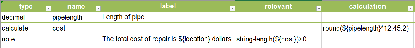

While you cannot use full XLSForm expressions within the label, you can use them in a calculate question, and then reference your calculate question in the label. Calculate questions will not show in your form, but will help you hold the output of full XLSForm expressions, so you can insert those values in a label. For example, lets pretend you want to use a dynamic label in a note to describe the total cost of repairs of a pipe, given its length:
The cost question is a calculate. It will not be shown in the form to the end-user. We use the cost calculate question to run a full expression that evaluates the total cost, and once we have that, we simply use it for our dynamic label.

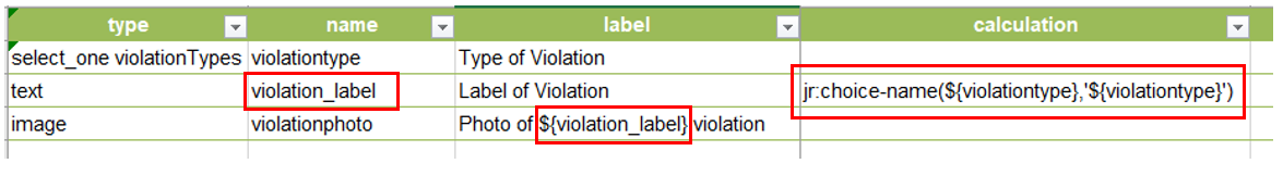

- Select_one questions: If you want to bring a user selection from a select_one question into a dynamic label, you have to keep in mind that by default, you are going to get the choice name value, not the label of the selected choice. If you want to display the label of the selected choice, then I suggest you use a calculate using the jr:choice-name() function.
Support for the XLSForm jr:choice-name() function was introduced in Survey123 in version 3.1 in both the field and web Survey123 apps. This function takes two inputs: a string representing a choice name, and a second string representing the name of the select question. Note that the second parameter requires you to enclose the question with quotes.
