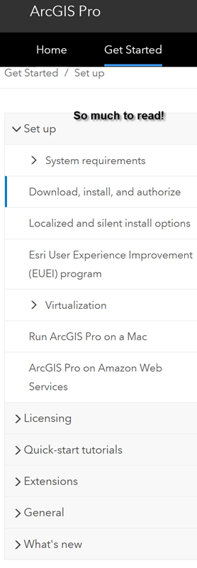

1 Follow the help topics:
ArcGIS Pro system requirements—ArcGIS Pro | ArcGIS Desktop
Download, install, and authorize—ArcGIS Pro | ArcGIS Desktop
2 Go back to step 1.
Really, it is good and should be read, especially the part about your computer being able to run the software

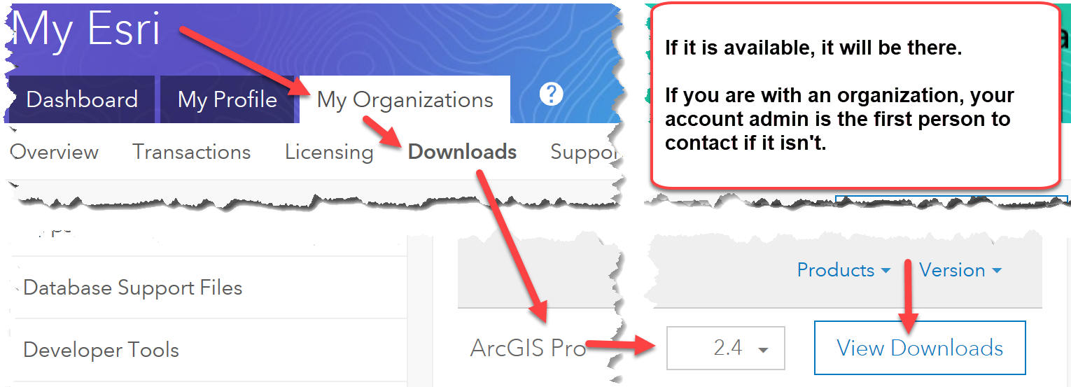

3 My Esri, My Organization, Downloads
If it is there, it will look like the following:

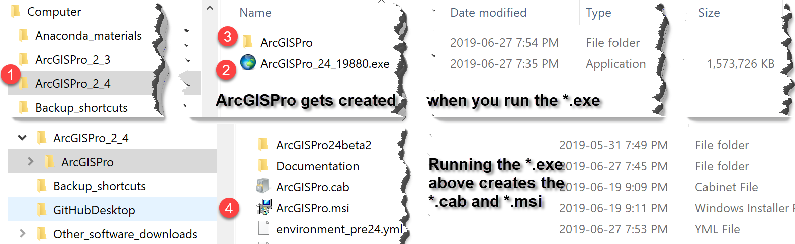

- Download the *.exe to that folder using Save As
- Right-click on the *.exe file and run it as administrator, specifying the above folder as the destination
- Do the same for the *.msi file and you will automagically get a bunch of stuff in that folder AFTER the installation is complete... just follow that, but your folder should look like the following
Where step 1 is the main installation folder you created and downloaded the *.exe (2), when you run the *.exe, you will get the folder in step 3, and run the *.msi and you get the rest of the stuff.

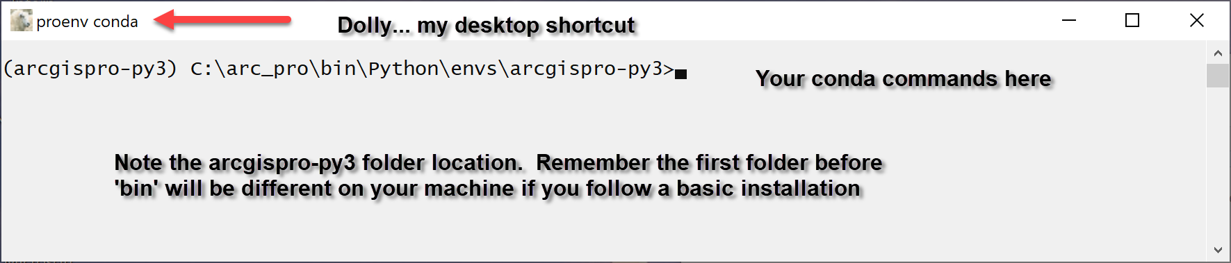

Crank up conda through whatever means to run ...proenv.bat which sets everything up. What is show below is what happens when I created a shortcut (Dolly) and messed around with the python ide so it isn't as dark and gloomy as yours will be.

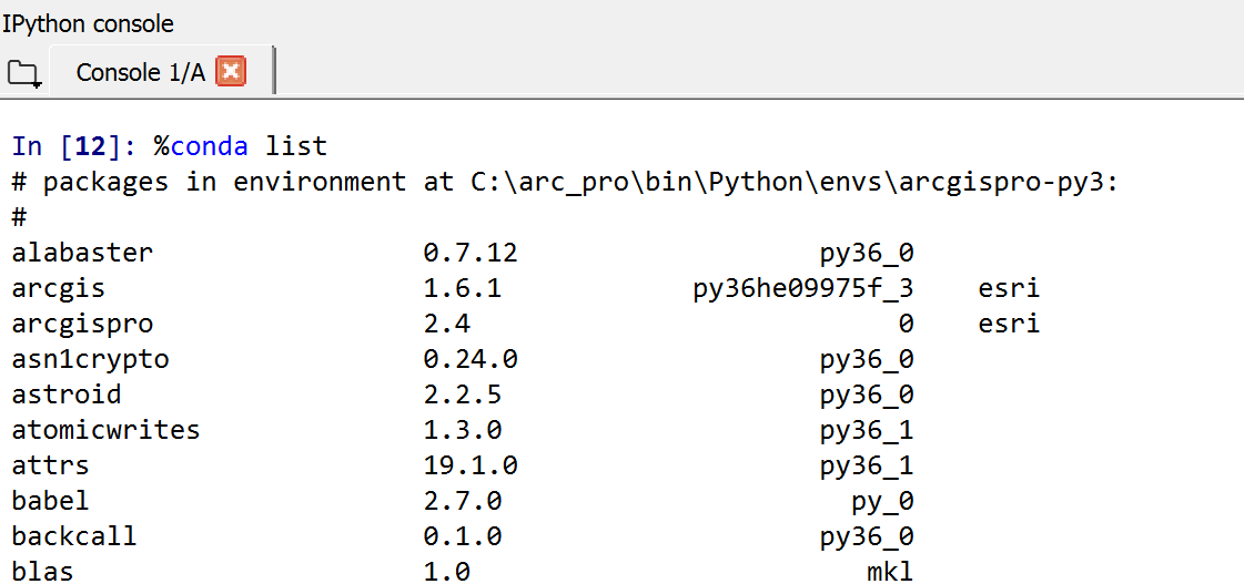

Revision History from this install
(arcgispro-py3) C:\arc_pro\bin\Python\envs\arcgispro-py3>conda list --revisions
2019-06-27 20:36:30 (rev 0) Fresh install of ArcGIS Pro 2.4 in this example
+arcgis-1.6.1 (esri)
+arcgispro-2.4 (esri)
... huge snip ....
+zeromq-4.3.1
+zlib-1.2.11
