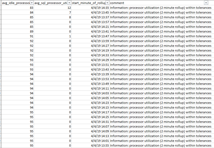

Processor
In the case of SQL Server, there is an evaluation in the Expert Excel file called “ProcessorUtil” (Processor Utilization; the Category is “Instance”). It provides a sample of the recent per-minute processor utilization by SQL Server on the machine. In this case, we can see that, for the sampling period, SQL Server uses almost none of the total processor resources of the machine on which it runs.
From this, we infer that, if this period is typical, the existing machine has many more processor resources than it needs. If all else is equal, the future system design can specify fewer processor cores to support the eGDB workload. Naturally, for this inference to have any integrity, you must run the tool during typical and/or peak workload periods.

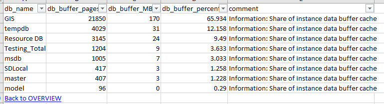

MemoryByDb allows you to see the amount of memory (in this case, rows of data as opposed to SQL statements or other memory consumption) used by each database.
In this case, we see that the “GIS” eGDB is the primary memory consumer in the SQL Server instance. So, it appears reasonable to understand that the eGDB can make use of the better part of the 3GB of instance memory. But, is that too much or not enough for good performance and system health?

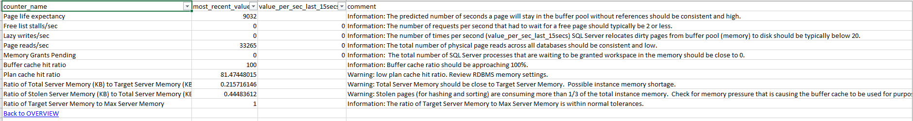

The MemoryMetrics evaluation reports on several memory metrics that can offer hints about how much in-demand the instance memory is. In this case, we see that there are warnings that suggest that the existing memory available the instance may be too low for the workload. Thus, we do not know if 16GiB of machine memory is too much or too little. But, we do have reason to believe that 3GB of instance memory is too little.
There are several other memory evaluations in the Expert Excel file. It takes experience and judgement to integrate these observations into an informed judgement about the true memory needs of the system. In this case, as in many cases, the inferences that one can make are incomplete. But, they are better than nothing.

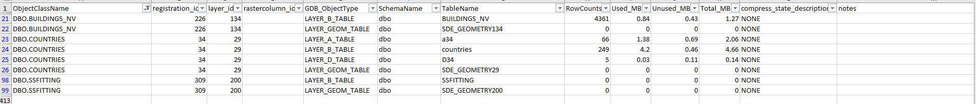

If you know the identity of the ObjectClasses to be exchanged there is information in the Content Excel file to report on the storage size and record counts of those item.
In the Storage category, there is a sheet called “ObjClass” (ObjectClasses). It reports, in considerable detail, the tables from which various eGDB ObjectClasses are composed, the number of rows that they contain, and the amount of storage that is allocated to each of them.
In the example below, there are three ObjectClasses of interest (filtered in the first column): BUILDINGS_NV, COUNTRIES, and SSFITTING. BUILDINGS_NV has about 4,400 records and consumes just over 1.25MB of space. COUNTRIES is versioned, with 249 records in the base table, 66 adds, and 5 deletes (the TableName column calls out the “A” and “D” table names for versioned ObjectClasses).
Thus, we can establish the record counts and approximate storage characteristics of ObjectClasses of interest in the eGDB. At the same time, we can also see which ObjectClasses are registered as versioned. This is critical information for establishing the range of options available for data exchange.

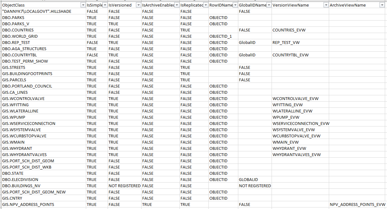

In the same Context Excel file, the ObjClassOverview (Inventory category) provides an overview of the versioning, archiving, and replication statuses of all of the ObjectClasses in the eGDB. This provides a more convenient mechanism for planning the range of data interchange mechanisms that would be appropriate for different ObjectClasses.

Versioned Data and Geodatabase Replication
If an ObjectClass is not already registered as versioned it may or may not be appropriate to do so for the purposes of making use of Geodatabase Replication. This relates to how the data is updated. Most data that is registered as versioned is updated “transactionally”, meaning that only a small percentage of the total records are changed at any given time. This kind of updating is compatible both with versioning and Geodatabase Replication. Other data is updated with methods like “truncate and add”, “delete and replace”, or “copy and paste”. In these cases, most of the records are updated, physically (even if the majority of record values happen to be the same, the physical records have been replaced). That kind of updating is not particularly well-suited to Geodatabase Replication. The information in egdbhealth can tell you about the versioning and replication status of ObjectClasses. But, it does not know how those ObjectClasses are actually updated. Hopefully, those that are registered as versioned are transactionally updated and therefore suitable candidates for Geodatabase Replication.
Archiving Data and Data Exchange
If an ObjectClass has archiving enabled, there may be additional considerations. For example, if the planned data exchange might increase the rate of updates, this could cause the quantity of archive information to grow in ways that are undesirable.
For versioned ObjectClasses that are archive-enabled, the archive information is stored in a separate “history” table. The size of that table does not impact the query performance of the versioned data. In this case, the main design consideration is whether it is practical to persist and use all of the archiving information. In many cases, it will be. But, making the determination requires knowing the archiving status of the ObjectClass and the planned rate of updates.
In the case of non-versioned ObjectClasses that are archive-enabled (and branch-versioned ObjectClasses), the archive information is in the main table. Thus, rapid growth of archive information can change the performance tuning needs of ObjectClasses and/or eGDB. Egdbhealth cannot know the future update needs for the data. However, it can report on the historical patterns of updates to non-versioned, archive-enabled ObjectClasses. The Context Excel file contains a “NvArchEditDatesSql” sheet that contains SQL statements for each non-versioned, archive-enabled ObjectClass in the eGDB. These statements are not run automatically because they are resource-intensive queries that do not provide information which is relevant to all circumstance.

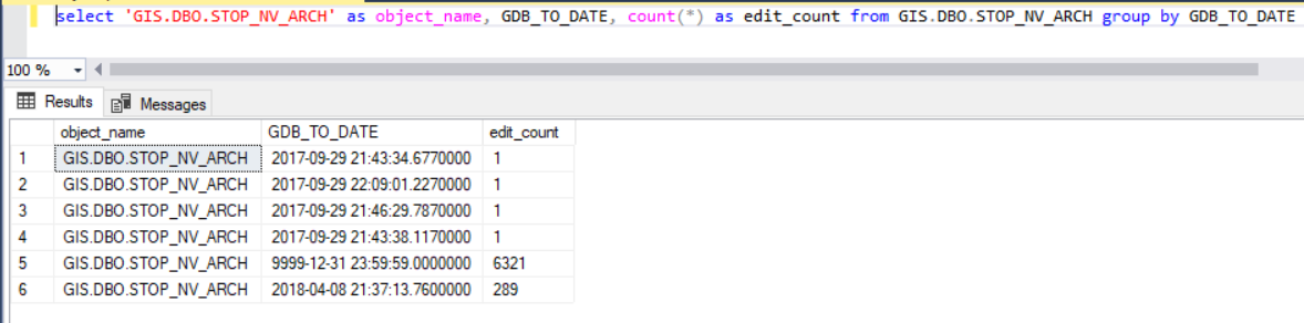

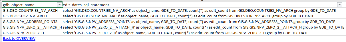

In this system design case, however, establishing the rate at which record have accumulated over time may be quite pertinent to planning a data exchange strategy. Use a SQL client such as SQL Server Management Studio to run the queries for the ObjectClasses in question to get a sense of the rate of data update. In this example, we can see a pattern for record updates where the typical update is small (1 record), but there was at least one occasion where there was a large update relative to the size of the ObjectClass (289 records on 8 April 2018):

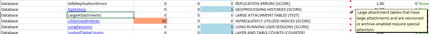

The Expert Excel file has an evaluation “LargeAttachments” that will automatically bring cases of likely concern to your attention. In the example below, the threshold values were not violated, so there was no negative evaluation:

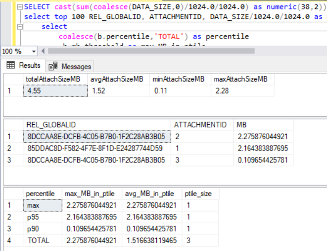

However, it may still be useful to know something about the nature of the existing attachments. The Context Excel file contains a sheet “AttachmentSizeSql” (“Inventory” category) that contains several SQL statements for each ObjectClass that has attachments.
Running these SQL statements in a client such as SQL Server Management Studio allows you to statistically characterize the attachments in various ways: aggregate statistics, top 100 by size, and percentile distribution.
With these statistics, you can understand not only the total amount of information, but whether it is due to a large number of small attachments or a small number of large attachments. Large attachments might be a greater risk for synchronizing over poor network conditions and might lead you to make a recommendation that data collection operate in a disconnected mode and synchronization occur under specific network conditions only.
Attachment size considerations might also lead you to offer recommendations about whether and how it would be practical to handle two-way synchronization (as opposed to one-way). While field-based users might have sufficient network circumstances to upload the attachments that they collect individually, two-way synchronization would mean that all of the attachments collected by other individuals (in the area of synchronization) would have to be downloaded. In some cases, this could be many times the amount of information that would need to be uploaded.
