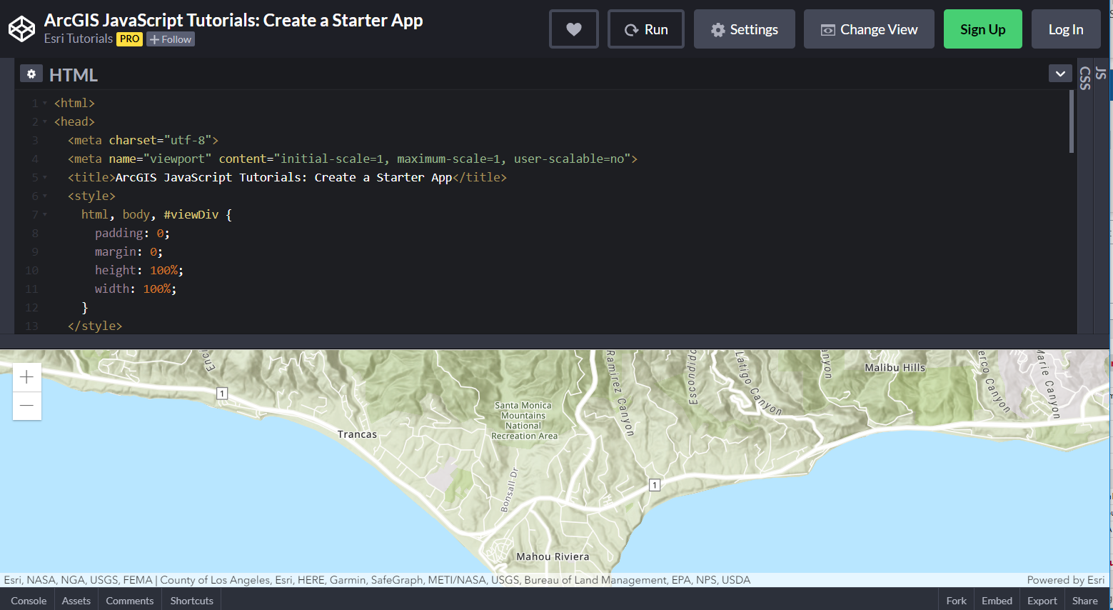

One of the best resources to learn GIS coding is the tutorials on the Esri Developer site. These include tools such as Python, REST API, PRO SDK, App Studio, and JavaScript. The tutorials are set up with instructions for inserting or adjusting pre-existing blocks of code; for example, see the Javascript tutorial on creating a starter app below. As students work through the tutorial and work with the code, they see how the code (top half of the screen below) drives the map (bottom half of the screen below); the map changes instantaneously as they progress through each tutorial. I like to think of it as "instant gratification" and find it a very effective means of learning!
One of the tutorials on the ArcGIS Developer site. Another one to look at is this one, with a spiffy color animation and time slider.

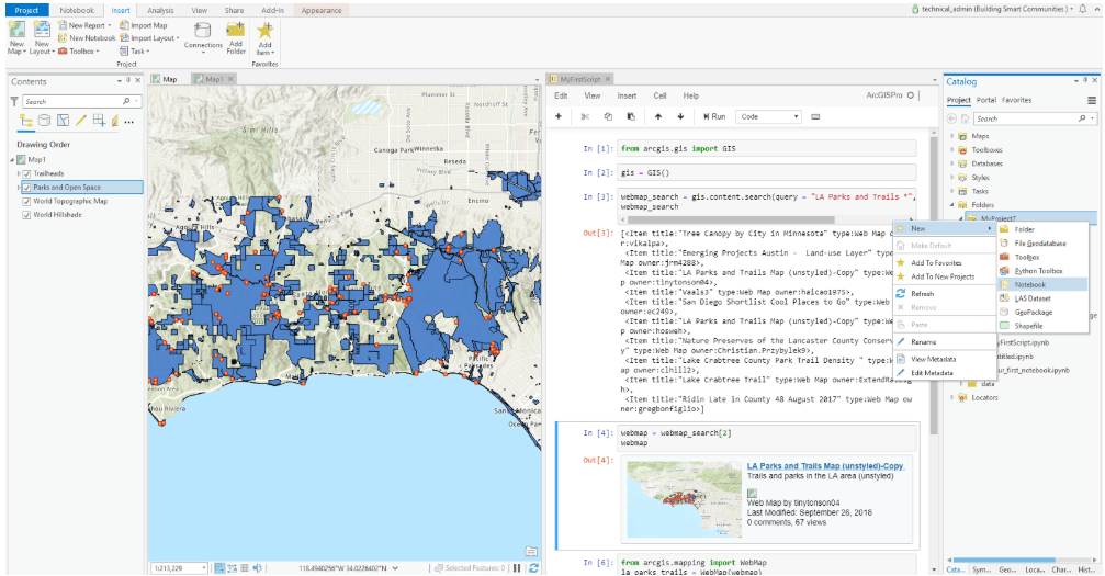

Finally and perhaps most importantly, the advent of Jupyter notebooks inside ArcGIS Pro (and soon inside ArcGIS Online) brings the power of Python to GIS users in an approachable and powerful way. If you have access to ArcGIS Pro, the notebooks are automatically included--nothing further to install, no libraries to add. My colleague Canserina Kurnia wrote an essay, here, recently exploring how to begin using these notebooks. Why does this matter? Now you can leverage the power of Python directly inside ArcGIS Pro--the best of both worlds. It is thus seamless to access and combine python libraries from ArcGIS Pro and open source Python in one integrated environment. The content in your map can also be easily accessed through code in the notebook window. You can work simultaneously with the notebook and the ArcGIS Pro user interface (UI). This integration makes it easier to incorporate python programming into your GIS courses. See what these Notebooks look like inside ArcGIS Pro, below.
Jupyter Notebooks inside ArcGIS Pro.
