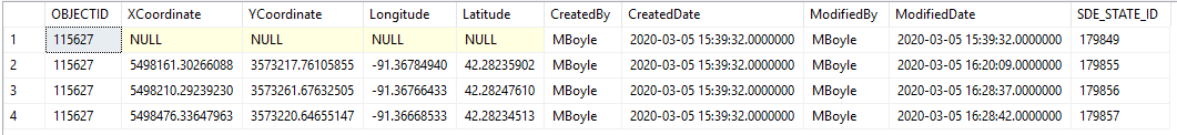

The trigger is on the add delta table of the feature class. The screenshot below is a query of the add delta table showing the edit history of a feature (most recent last). The trigger should update the XCoordinate, YCoordinate, Longitude, and Latitude fields after insert. You can see that on the initial insert of the feature, those fields remain NULL. Any edits after initial insert (rows 2-4) show those fields getting updated.
Is there some reason the trigger isn't working on the initial insert of the feature? I am testing by editing through a web map in ArcGIS Enterprise (10.7.1).
