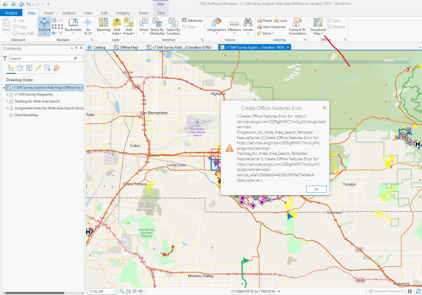

Real-world Problem: In order to be prepared for local disasters (no notice events) I am helping my search and rescue team develop offline workflows. We need to be able to use ArcGIS Pro 2.5.2 with our Maps and Apps in both on and offline environments.
Technical Problem: Following these steps Take a map offline—ArcGIS Pro | Documentation I get a Create Offline Features Error, but with no explanation.

This ended up being a file path issue either because the template folder I was using contained brackets (based on the template folder that Wildland Fire GIS use, on actual incidents you remove these, but I was just doing some testing) or the location where the project was stored.
Once I opened the project up in another folder I was able to easily download the Offline map.
So in short, if you get this vague error, trying changing the file path and/or remove any special characters (which I humbly admit should have been more obvious to a long time GISSer).
