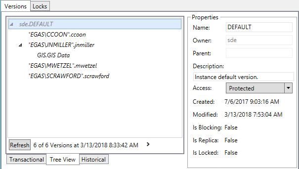

I created a version called GIS.GIS Data so that operators out in the field could GPS data and I could review it and post the edits to my own version before reaching the Default. My only concern is that our current reconcile and post scripts is grabbing data from each of the child versions under the Default each night. Is there a command in python that would exclude any child versions created underneath another child version from being reconciled and posted to the default? I am very new to the workflow and I would really appreciate some guidance. Thanks
