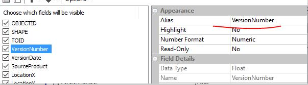

In the MXD when authoring the document to define the service I set the aliases:

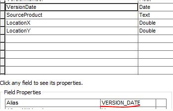

Because aliases in the FC in FGDB are not good:
But when I publish this as MapServie to ArcGIS Servier the Aliases are read from FC in FGDB and not from MXD settings?
I tried publishing the service under a new name, adding the layer from scratch to MXD and i keep seeing the alias set in MXD being overriden by FGDB. Is this expected or is this a Bug?
