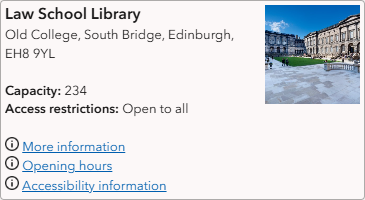

ARCADE used to render this image as a 100px by 100px thumbnail:

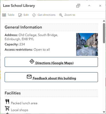

How it displays in Map Viewer: [note the image is squashed horizontally]
How it displays in a Card Widget in Experience Builder: [note the image is not squashed at all and is cropped retaining the central section (this is what I'm trying to replicate in Map Viewer)]
