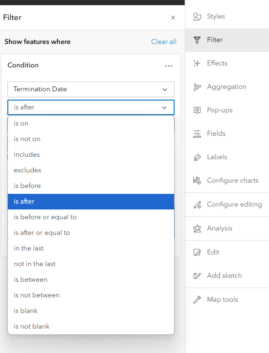

These are the current date conditions available, and there is no option to filter based on current year. The 'in the last' and 'not in the last' options are close, but they don't allow filtering based on the current calendar date unit.
