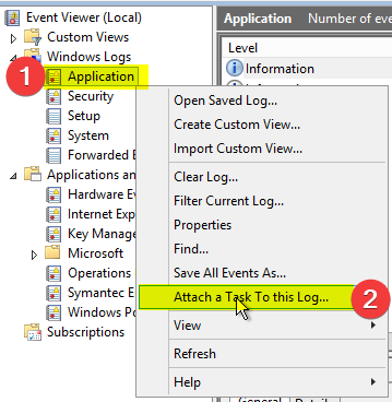

Setting up Task Scheduler to monitor the event log
Right-click on the Application Log and select Attach a Task To this Log

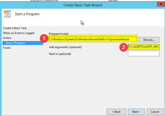

When you get to Action, select the PS script you created for Application Events
Finish the Basic Task Wizard then go into Task Scheduler and set things up to run as a service account, etc.

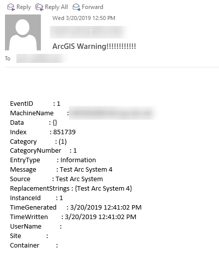

Testing
From an administrative PS prompt:
PS C<SPAN class="punctuation token">:</SPAN>\Windows\system32<SPAN class="operator token">></SPAN> New<SPAN class="operator token">-</SPAN>EventLog –LogName System –Source <SPAN class="string token">"Test Arc System"</SPAN>
PS C<SPAN class="punctuation token">:</SPAN>\Windows\system32<SPAN class="operator token">></SPAN> Write<SPAN class="operator token">-</SPAN>EventLog –LogName System –Source <SPAN class="string token">"Test Arc System"</SPAN> –EventID <SPAN class="number token">1</SPAN> –Message <SPAN class="string token">"Test Arc System 4"</SPAN>
PS C<SPAN class="punctuation token">:</SPAN>\Windows\system32<SPAN class="operator token">></SPAN> New<SPAN class="operator token">-</SPAN>EventLog –LogName Application –Source <SPAN class="string token">"Test Arc"</SPAN>
PS C<SPAN class="punctuation token">:</SPAN>\Windows\system32<SPAN class="operator token">></SPAN> Write<SPAN class="operator token">-</SPAN>EventLog –LogName Application –Source <SPAN class="string token">"Test Arc"</SPAN> –EventID <SPAN class="number token">1</SPAN> –Message <SPAN class="string token">"Test Arc Application 4"</SPAN>
<SPAN class="line-numbers-rows"><SPAN></SPAN><SPAN></SPAN><SPAN></SPAN><SPAN></SPAN></SPAN>
And you should see:
