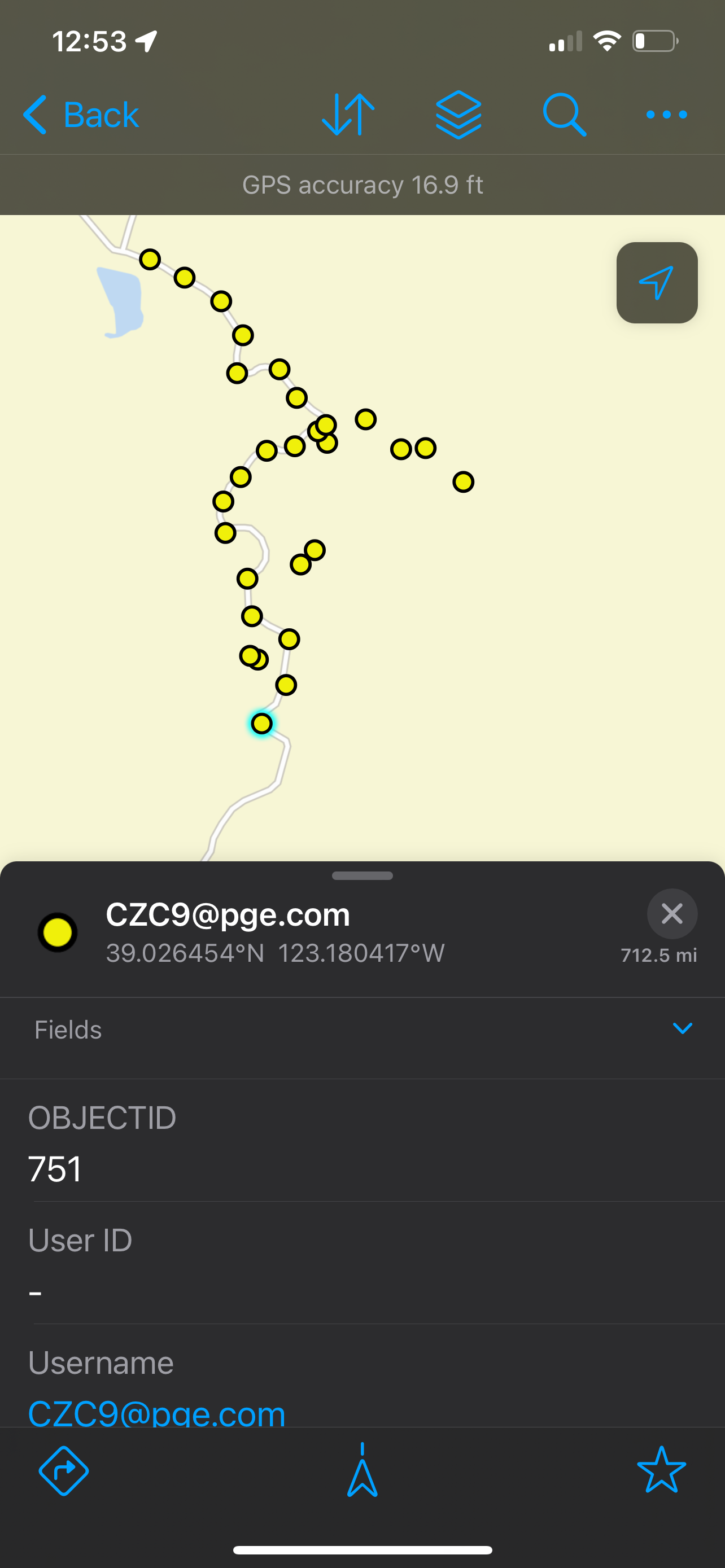

Before edit, we have one feature at this location with status "pending":

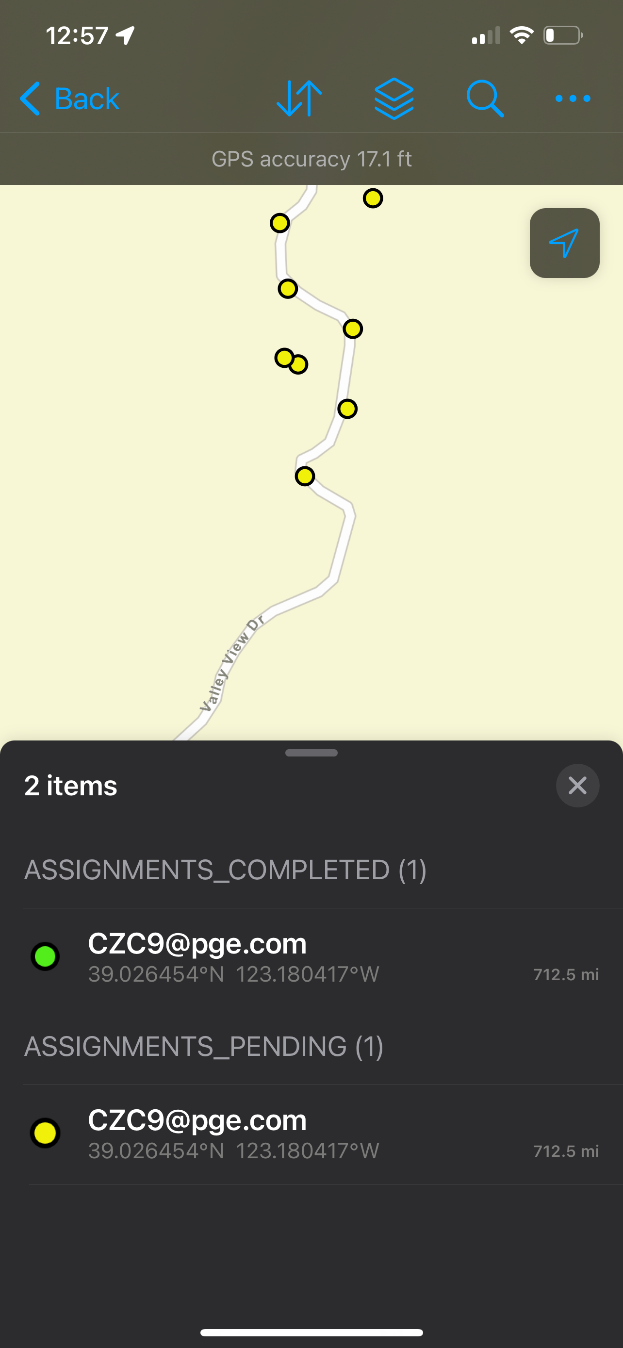

After changing the status to "completed" and syncing the offline map area, we now have two points at the same location, showing both statuses:
