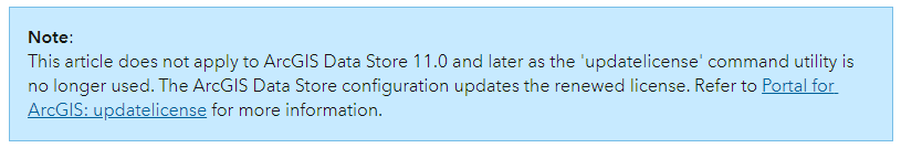

Hi Everyone:I am attempting to apply new licensing to my Enterprise installation.When updating the license for ArcGIS Data Store, I usually go to the Data Store tools folder and run the 'updatelicense' batch file.I panicked! The utility isn't there! I search the web and find this:https://support.esri.com/en-us/knowledge-base/how-to-update-the-arcgis-data-store-license-via-command-000029719
...and at the top of the page...
Okay, I am at 11.1 and I need to follow the link...https://enterprise.arcgis.com/en/portal/latest/administer/windows/data-store-utility-reference.htm#ESRI_SECTION1_0579C1DD4CE44C6F845ED3A192B4205E
It takes me to the top of the Data Store Command Utility Reference because the 'updatelicense' section no longer exists.
Can anyone tell me how the Data Store license is updated in 11.1?
Thank you,Adam
ArcGIS DataStore will check for an updated license file from ArcGIS Server on a regular basis. When updating ArcGIS Server's license it may take up to 24 hours, but DataStore will populate itself with that new information.
With Enterprise 11.X, the DataStore license is automatically updated as part of the upgrade process, as a way to help simply all the steps involved. Hope that help relieves the panic, but I do agree it's not overly clear from that notice that it's taking place behind the scenes.
