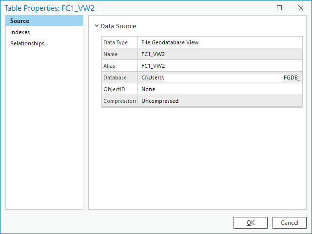

But that doesn't seem to work for file geodatabase views. There isn't a Definition section in the view's properties:
Could that SQL Definition functionality be added for file geodatabases too?
