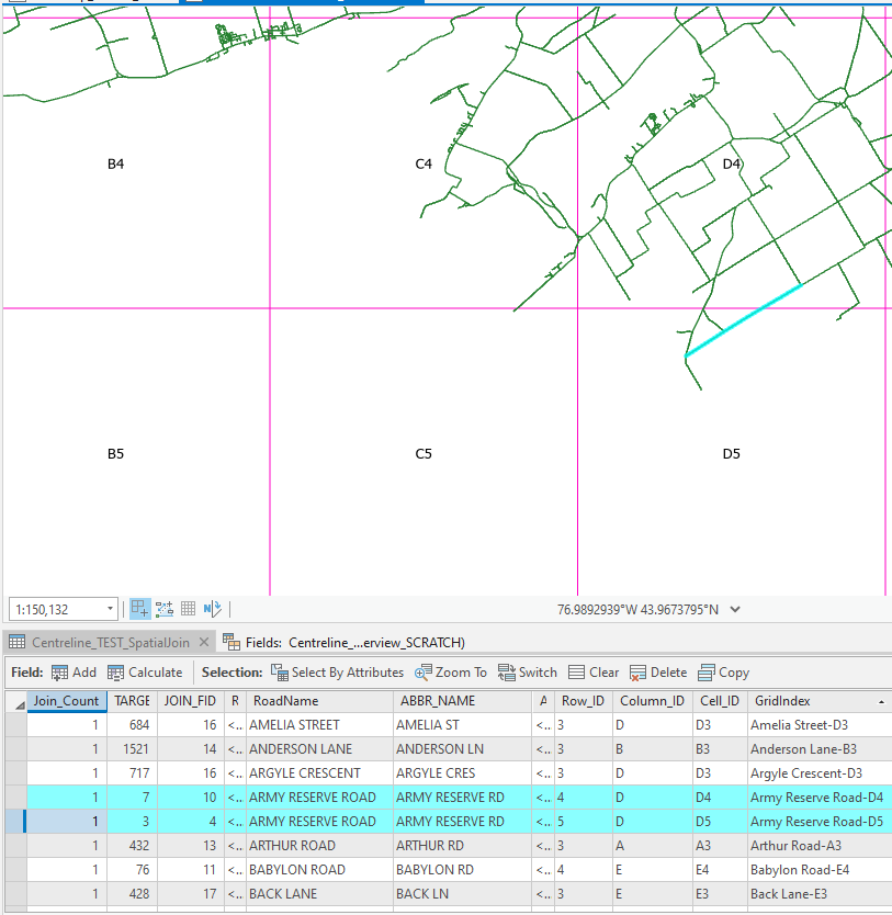

I am trying to create a street name index as described in this post from 2007 Creating street name indexes (esri.com). I would like to know if it is possible to create an arcade script to create the final table rather than manually manipulating the data in excel. For example, I would like my final GridIndex field attribute to populate on one line as Army Reserve Road-D4, D5

I may have to perform some manual manipulation anyways. I will be left with 4 Army Reserve Roads since there are 4 road segments for this road:
Cell_ID: D5
Cell_ID: D5,D4
Cell_ID: D4
Using the dissolve tool as suggested in the 2007 post will only remove 1 instance of Army Reserve Rd-D4. I suspect that I will be left with 3 features: Army Reserve Rd-D5, Army Reserve Rd-D5,D4, & Army Reserve Rd-D4

I guess it's a bit complicated. My original road layer contains multiple segments for a single road (4 for Army Reserve Rd). 1 in D4, 1 that crosses D4 & D5, and 2 in D5.
The process in the 2007 article states that the duplicated roads/cellID's be removed using the dissolve tool AFtER the spatial join has been performed. in this case I would have 4 features: Army Reserve:D4, Army Reserve:D4, Army Reserve D5, Army Reserve D5. The dissolve would then remove the duplicates and leave me with Army Reserve:D4 & Army Reserve:D5
Your original suggestion was to concatenate the CellID's during the spatial join process which, in the 2007 article, is performed BEFORE the duplicated roads are removed. I would again then be left with 4 Army Reserve Rd's:
Army Reserve:D4
Army Reserve:D5
Army Reserve:D5,D4
