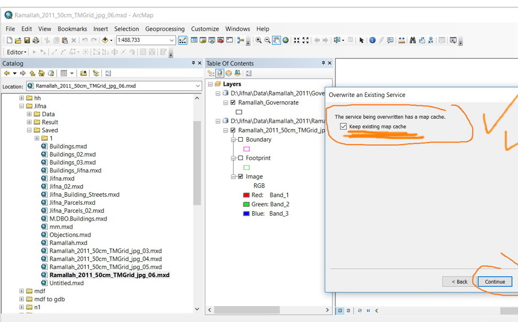

ArcGIS Pro 2.6: Pro has no equivalent message to “the service being overwritten has a map cache” with the “keep existing map” option,
I got to know that the best practice to transfer cached services from machine A (that has ArcGIS Server installed) to machine B (that has ArcGIS Server installed) is:
- To copy the cached service from machine A to the folder set as cache folder in machine B
- Then the service needs to be published with the “overwritten” option on the ArcGIS Server of machine B
- In ArcMap, the screenshot below is used to pop up to tell that “the service being overwritten has a map cache” along with the “keep existing map” option. Why this message is not available in Pro?
This issue is already reported here:
What is the best practice to transfer\configure already cached service published with ArcMap by using ArcPro?
