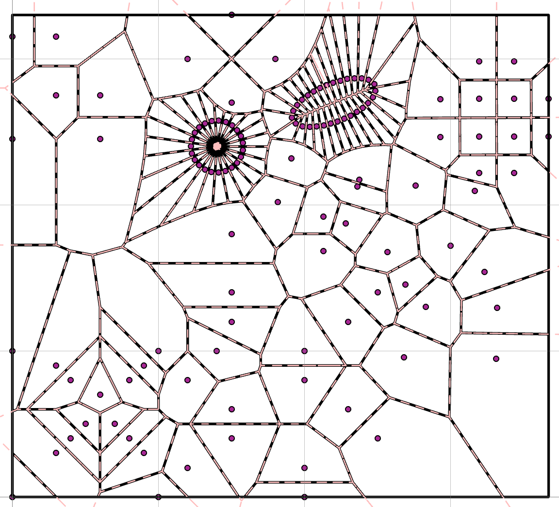

The Voronoi results obtained from
Create Thiessen Polygons—Help | Documentation
and from npg. are shown in the figure below.
It doesn't really matter which is which since they identical in shape and area.
Note: The esri tool buffers by an extra 10% by default, the npg version defaults to the input extent, so ignore the "to infinity" polygons on the edges

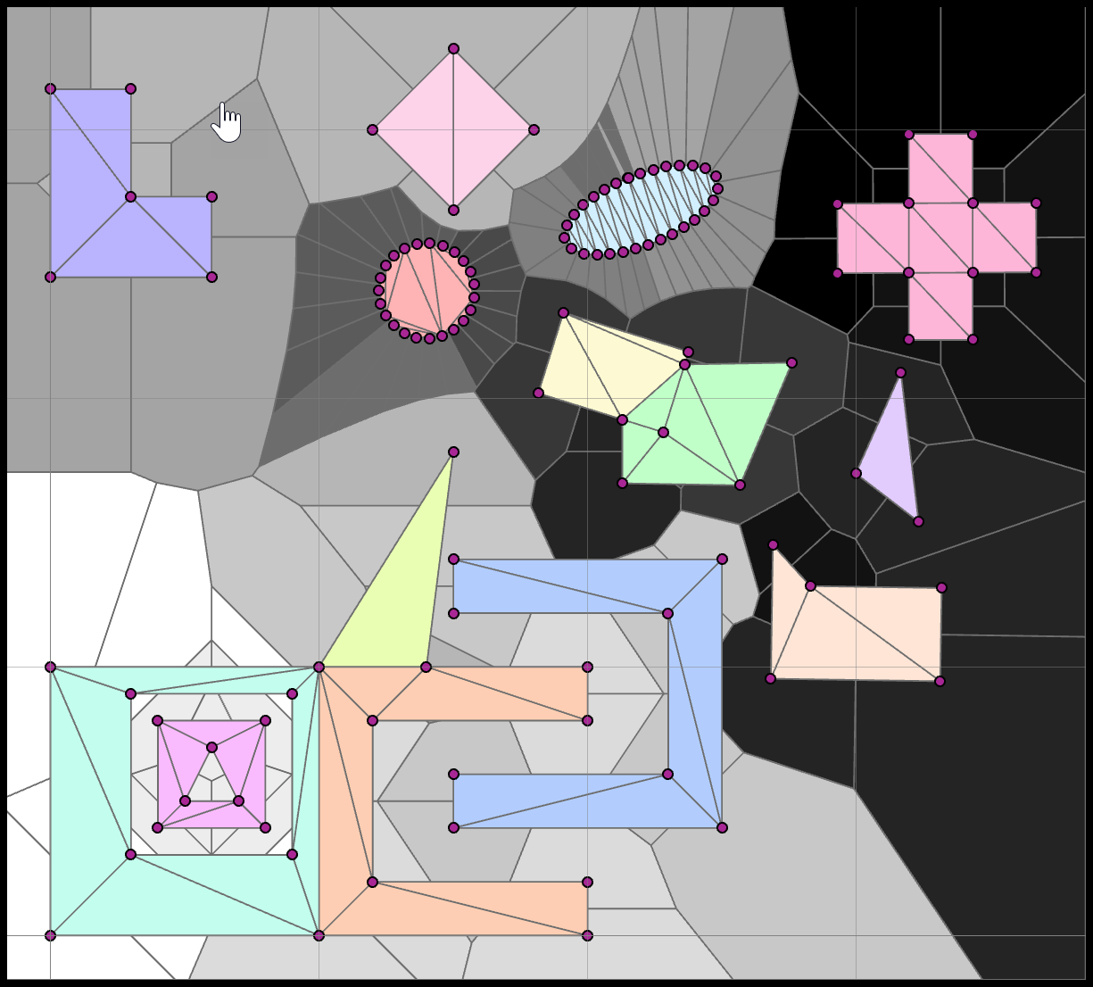

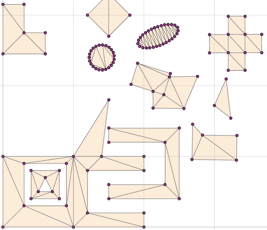

I like Delaunay triangulation for shapes. The figure below shows a such a triangulation performed on a variety of shapes, using the npg Delaunay option.
You can generate your own art or derive medial axes/skeletons from these.
