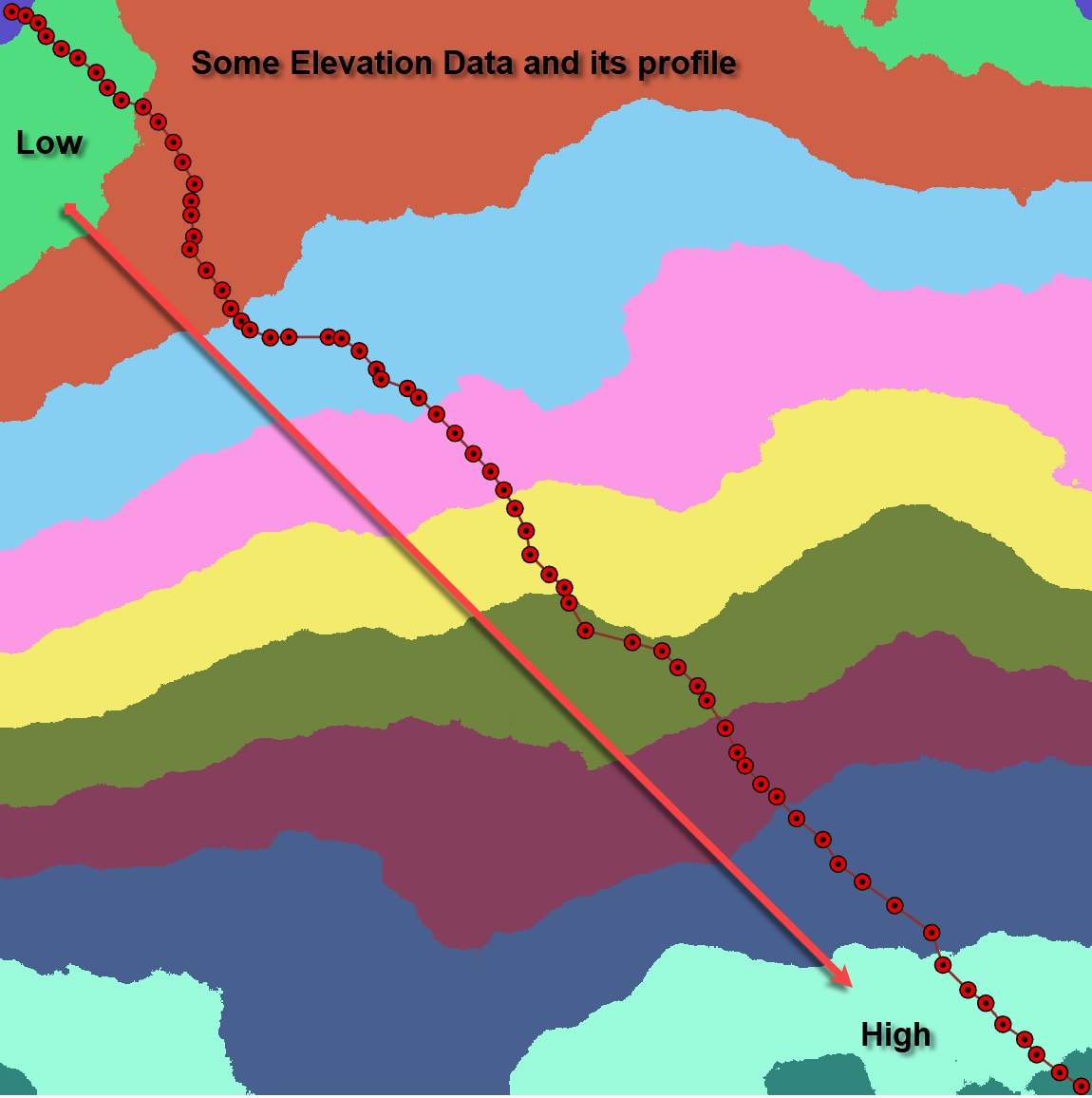

Conventional application
- Take a DEM
- Construct a 3D polyline (Z-enabled) representing a profile path along it
- Densify it at some increment if you want to sample more elevation points along the line, but are too lazy to do it as you go (or you forgot). This is optional, but there are builtin tools and/or 3rd party tools to do this (including some of mine)
- Feature vertices to points, to get the path as points
- Extract values to these points.
- Extract Values to Points in the Spatial Analyst
- If you don't have SA, there are ways to get these data, but that is for another blog
- Add Geometry Attributes to get the x, y and z values for the points.
- Off to numpy

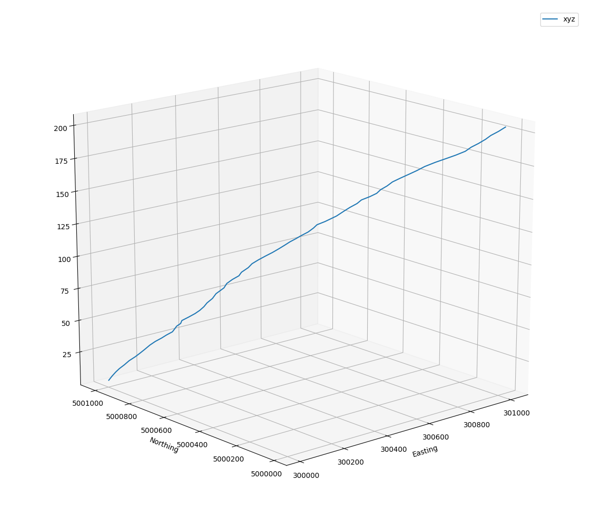

The Map and the Profile
Start low, go high, or vice versa. Vertical exaggeration on the Z values
Calculations

3D Total, sequential
- 1519.95,
- array([13.82, 13.88, 14.71, 18.66, 17.94, 22.19, 17.91, 17.74, 21.5 , 20.31,
... snip
37.66, 42.96, 32.17, 33.32, 20.96, 25.64, 25.02, 18.28, 27.46, 24.34]))
