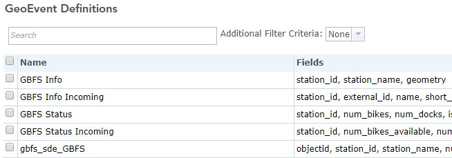

In the image above, GBFS Info and GBFS Status (probably should have been labeled “Outgoing” for consistency) were both copied and edited from gbfs_sde_GBFS (our Feature Service), while the two ending with “Incoming” were automatically generated when creating the Input Connectors. The beauty of using GeoEvent for a scenario where all the inputs will have a reliable schema is that we should only need these 4 definitions to facilitate an arbitrary number of inputs/providers. After creating an Output Connector (Update a Feature) that will move incoming values into our Feature Service, all that is left to do is publish a GeoEvent Service with 2 Processors (Field Mapper) that will map the bike-share information and status feeds to their corresponding fields in the output.

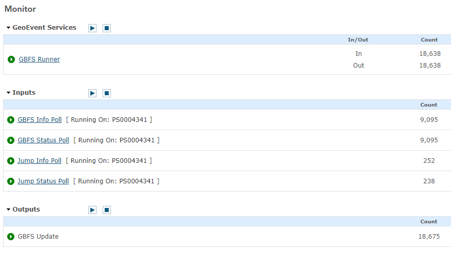

Shown above is the baseline we need in GeoEvent to build an Operation Dashboard that will display real-time updates to our bike-share feeds. If our manager comes through the door with another provider (let’s say Jump), all we do is create 2 more Input Connectors, ensure they are pointed at the correct Field Mapper, and then update our GeoEvent Service (shown below).

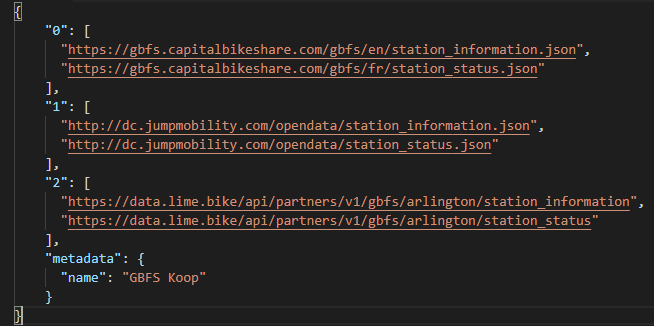

For simplicity, we will define the information for the bike-share feed in the default.json file that ships with the provider sample; this allows us to write less code and use what is already inside the provider sample for model.js. Just assign a number (starting at zero) to each pair of station URLs and include some metadata information to help clients consuming our final Geoservice.
This JSON file handles the information that would have been specified in the Input Connectors we needed with the GeoEvent solution. With the bike-share feeds stored somewhere, we can start working on the core of this Koop application: model.js.

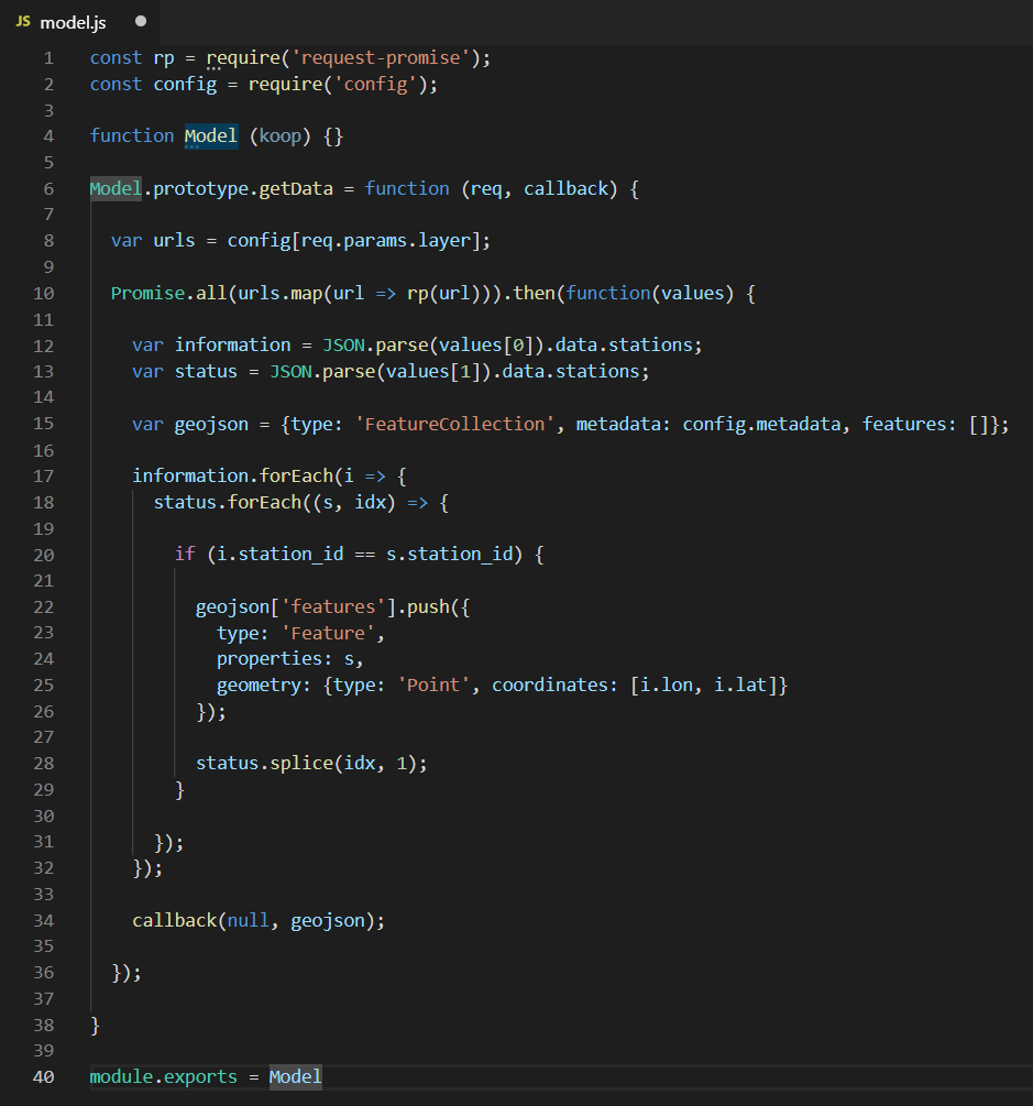

The 40 lines of JavaScript shown above are accomplishing what we outlined in our approach with GeoEvent. All we are doing is grabbing the layer id from the request (e.g. 0 which is for the Capital Bike Share), fetching the JSON response from both endpoints in the configuration file, and then creating a feature for each station. However, there is something powerful about how the properties for each GeoJSON feature are being built and this can be seen at line 24 (properties: s). Since we are not relying on a published service with a fixed schema, we can append whatever properties we want to the outgoing feature. This mean our logic within Koop can remain unconcerned about the details of a given provider and that is one of the huge benefits of this approach. There is also a bit more flexibility in how we manipulate the data before it goes back to the client since we are not restricted not to the out-of-the-box Filters/Processors in GeoEvent, but simply to whatever we can do with JavaScript.
