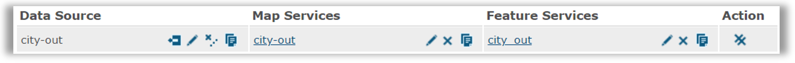

In order to review/change my Data Source's properties I navigated Site > GeoEvent >Spatiotemporal Big Data Stores. I was presented with the following:

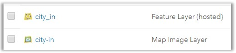

At first glance I feared it had failed to create the Map Service. But I wanted to be sure it had not been created before I created a new one. So I consulted the Portal Content and was surprised to see both of my services listed there:

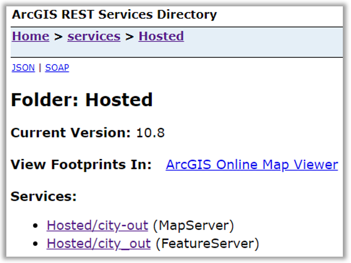

I also looked into the ArcGIS Server REST services and found them to be there and functioning properly:

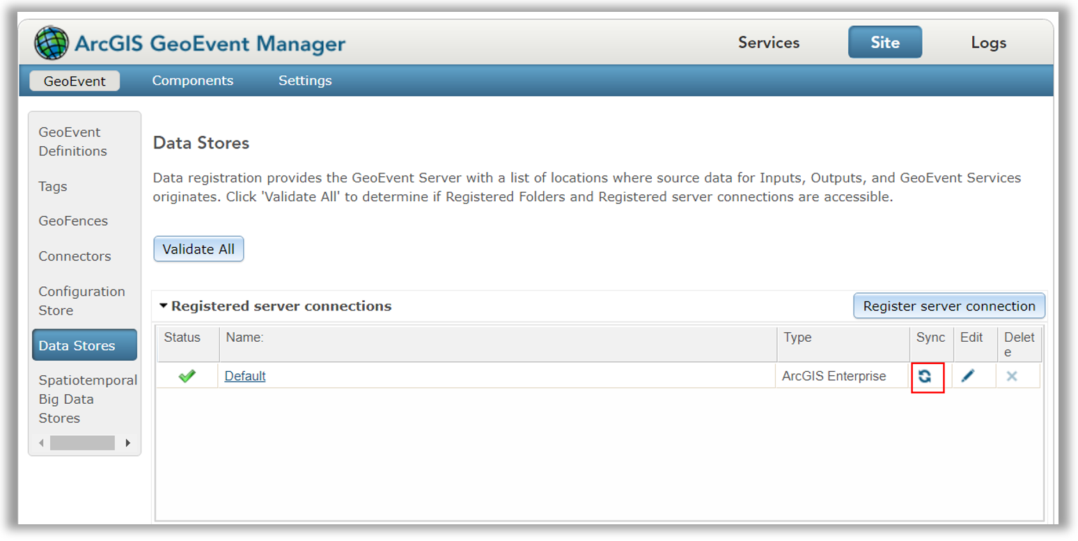

Seing my services on the Enterprise made me suspect that communication between GeoEvent and the Enterprise had somehow gone wrong. Returning to GeoEvent Manager, I navigated to Site > GeoEvent > Data Stores, located my connection to the enterprise (in my case it was default) and pressed the Synchronize button.
Doing the synchronization caused GeoEvent to update its cache of content on the Enterprise, including the Map and Feature Services related to my Data Source. Now when I go to Site > GeoEvent >Spatiotemporal Big Data Stores my Data Source lists the appropriate services:
The Issue
When GeoEvent sends the request to create the Map and Feature Services, it will only wait so long before timing out. Because of this, if the response from Enterprise is delayed for any reason, GeoEvent will continue on without the service information. Synchronizing the Data Store in GeoEvent Manager causes GeoEvent to re-cache the content on the Enterprise, including the services related to the BDS Data Source.
