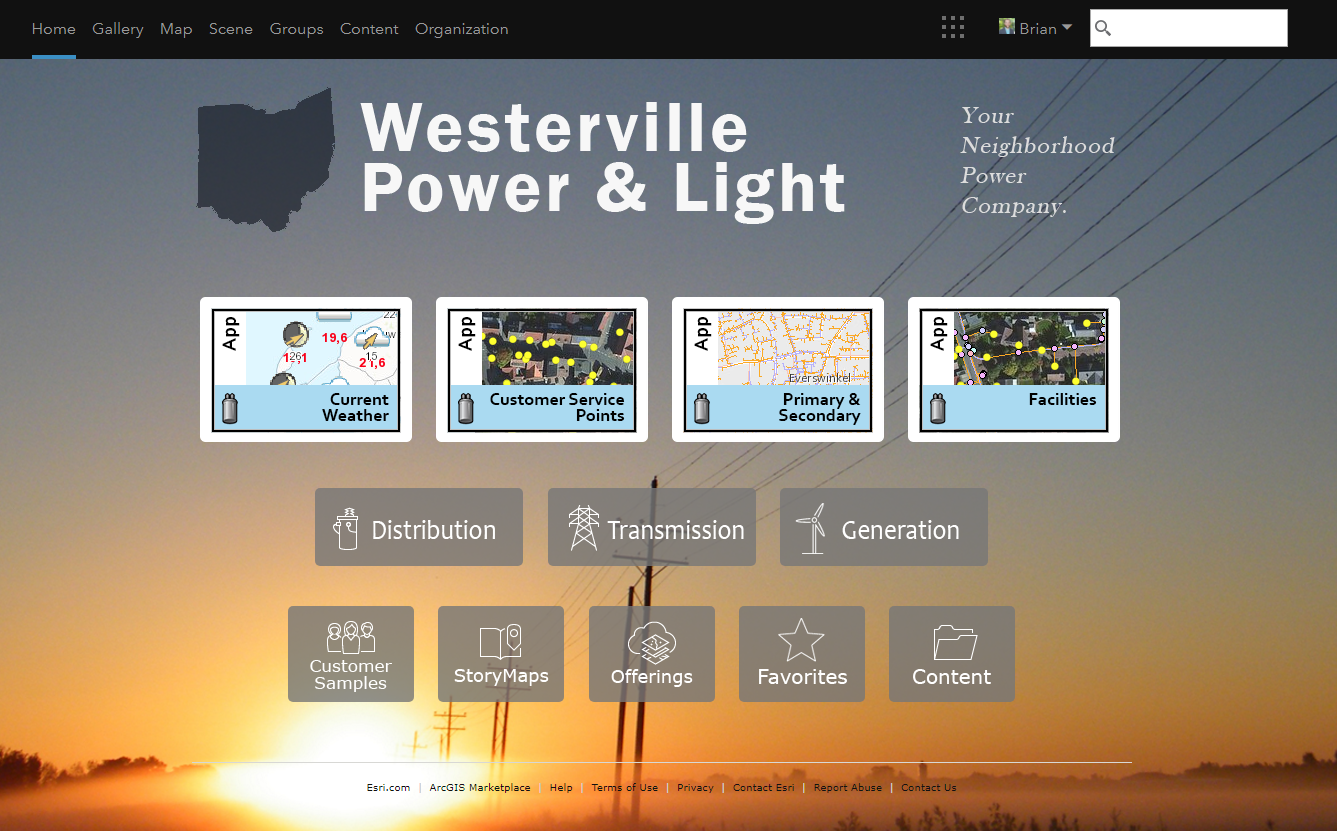

We frequently get questions from customers about how to to style their ArcGIS Online/Portal homepages, similar to the demonstration sites that we designed for our Electric and Gas sites. This blog is going to walk through the way that we styled our homepages, as well as providing all of the source code and imagery.
Westerville Power & Light Homepage, our fictitious electric utility demonstration site.

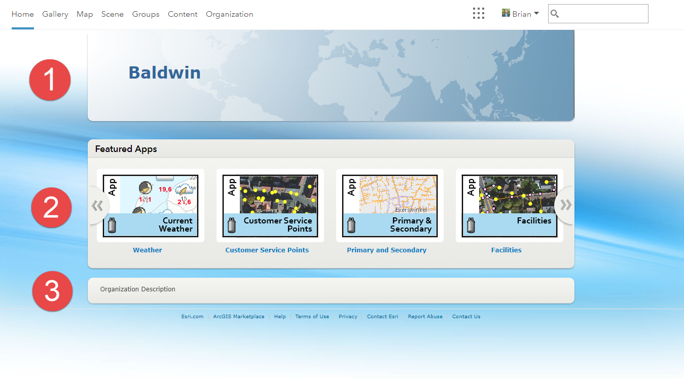

So, let's start with a blank slate:

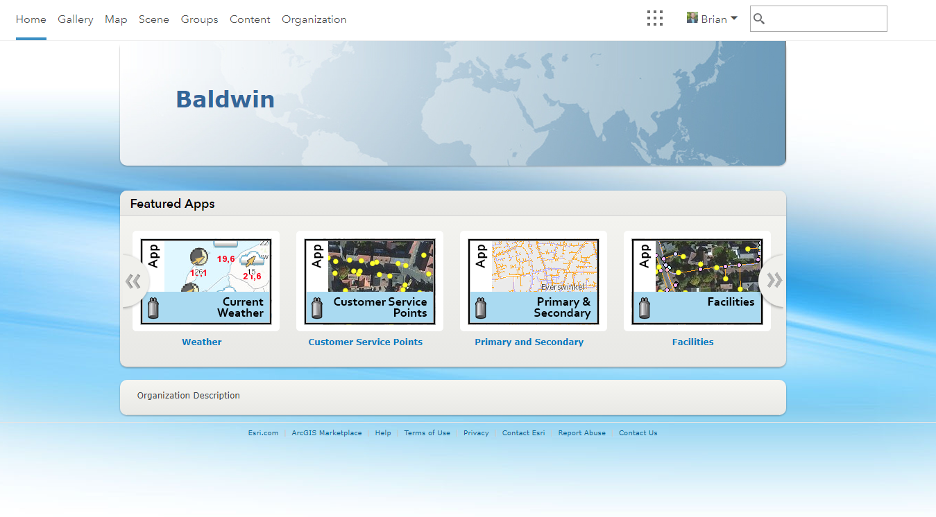

This is what pretty much every organization homepage starts out looking like. Eek. So, how do we make this look better? Honestly, with a couple of code snippets and images, it takes about 5 minutes.
After you open the attached .ZIP file, you will find 2 HTML files: Organization Description and Banner. The sections are titled for the sections of the ArcGIS Online/Portal settings that this code can be pasted into. The standard homepage is composed of roughly 3 different elements: 1 - Top Banner, 2 - Featured Content, and 3 - Organization Description. Open up the file titled Banner.html and we will work on styling Top Banner, Featured Content, and the background.

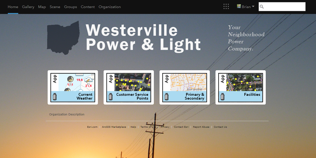

In the code, the last two elements you will see in the <style> section are the #topBanner and #resback. For both of these, you can see that we are simply applying a background image to the DIV and then placing the element. #topBanner is placing the header banner image and #resBack is placing the background image at a fixed position.
In ArcGIS Online, navigate to My Organization, Edit Settings, Home Page, and set the Background Image to No Image. Then, set the Banner to 'custom design', click the code view icon, and paste in the Banner.html contents.
Looks pretty good already!

</div> Now, take all of the OrganizationDescription.html code and navigate to Organization, Edit Settings, General, Organization Description, click the code icon, and paste everything in. After you hit save and go to Home, you'll end up with this great finished product:
