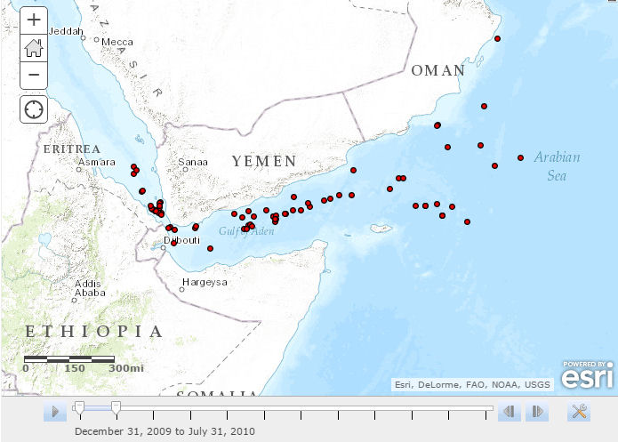

- In My Content, right-click the web layer and add it to a new map.
You can immediately see that the web layer is time-enabled because a time slider displays at the bottom of the map viewer.
On the map, only the points from a specific time span are displaying.
- In the Contents pane, click the ellipsis button under the layer's name, then click Disable Time Animation. All the layer's points now display on the map.
Each point represents a hostile act against a maritime vessel between 2010 and 2015 in subregion 62, which includes the Gulf of Aden and Arabian Sea (the data is from the U.S. National Geospatial-Intelligence Agency's Maritime Safety Information Portal).

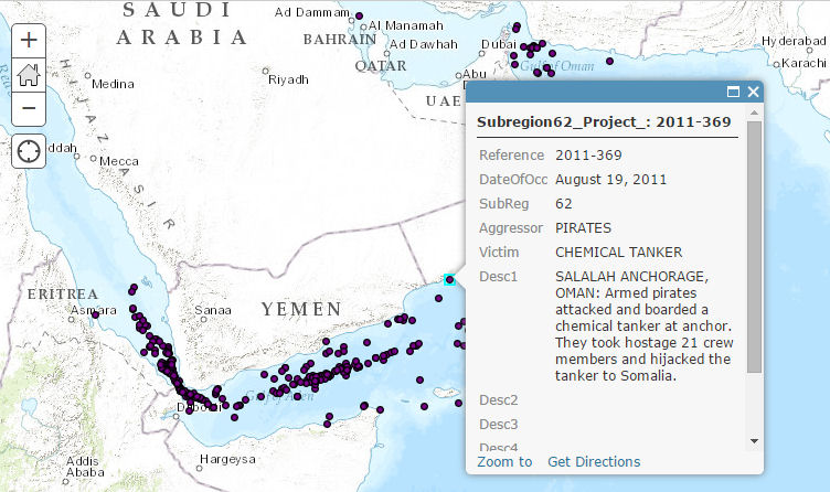

When making a web map, you need to decide what information users should see when they click a feature on the map.
Currently, all layer attributes display in the pop-up. Some field names are cryptic or irrelevant to the general audience this map is intended for.
You can configure the pop-up to be more user-friendly.

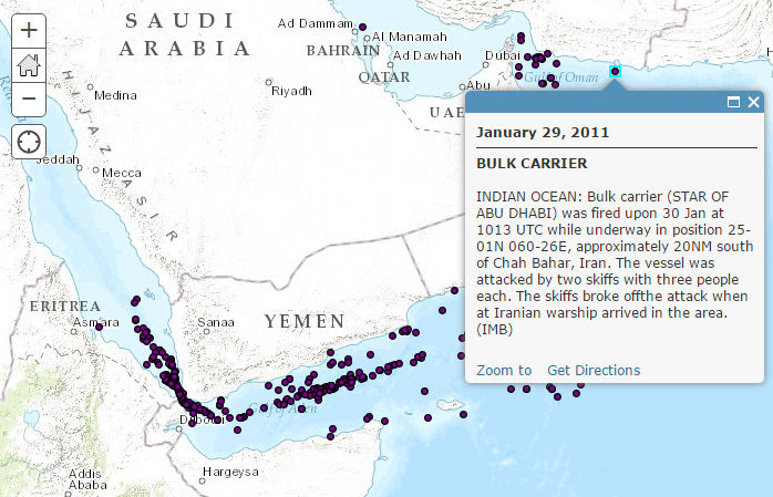

- In the Contents pane, click the ellipsis button under the layer name, then click Configure Pop-up.
The pop-up title is currently set to display the layer name followed by the incident reference number. Unless you're familiar with the data, this information isn't easy to understand.
In the Pop-up title box, delete the existing content, then click the plus sign to see the fields list. Click {DateOfOcc}.
Next, configure the pop-up content.

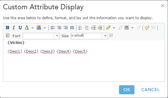

- Under Pop-up Contents, click the down arrow next to Display and choose "A custom attribute display." Click Configure.
- In the Custom Attribute Display dialog box, click the plus sign and add the {Victim}, {Desc1}, {Desc2}, {Desc3}, {Desc4}, and {Desc5} fields. Add a space between each field.
- Select {Victim} and click the bold button. Add an extra paragraph return after the {Victim} field.
- Click OK, then Save Pop-up.
Now the pop-up presents focused information (incident date, victim, and details) that is appropriate for a general audience.

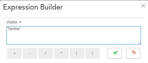

- Mouse over the Victim field name, click the gear icon, then click Calculate.
- In the expression box, enter 'Tanker' (in ArcGIS Online, text values are enclosed in single quotes). The expression reads Victim = 'Tanker'.
- Click the Validate checkmark button to make sure your expression is valid, then click Calculate. Note: There's no undo on table edits.
Now all the Victim values for the filtered records are Tanker.

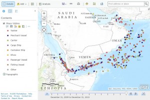

Symbolize the Points
Now that you've standardized the victim values, you can symbolize the layer using unique symbols.
- In the Contents pane under the layer name, click the Change Style button.
- In the Change Style panel, choose the Victim attribute, choose to style by unique symbols, and click Options.
You can change the color, size, and shape of individual symbols or all of them if desired. You can also adjust symbol transparency. The default settings are fine for this map.
There are three remaining victim types that don't fit into the standard categories. You can move them into the Other class by selecting their row, then dragging the row down below Other.

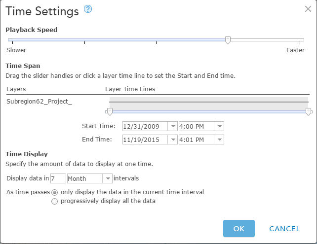

- Click the wrench icon next to the time slider, then click "Show advanced options."
You can adjust settings including the time span duration, start and end times, playback speed, and more. For this map, the time settings are fine.
