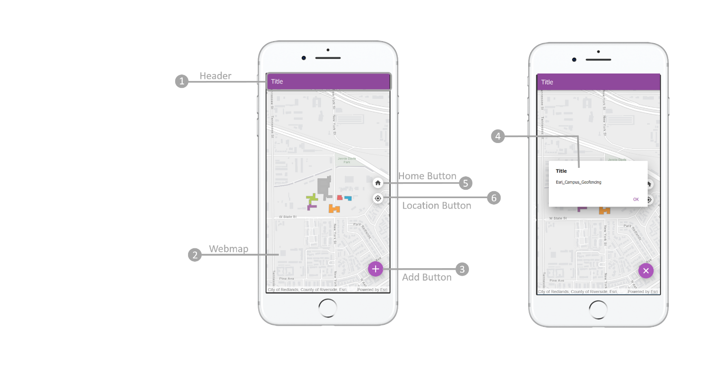

You will create an app that looks like the illustration below, the main features of this app include:
- Load a public Web Map
- Tap on the Add button to display Web Map name on a pop-up
- Tap on the Home button to return to the initial Web Map extent
- Tap on the Location button to display the current device location
Final result:

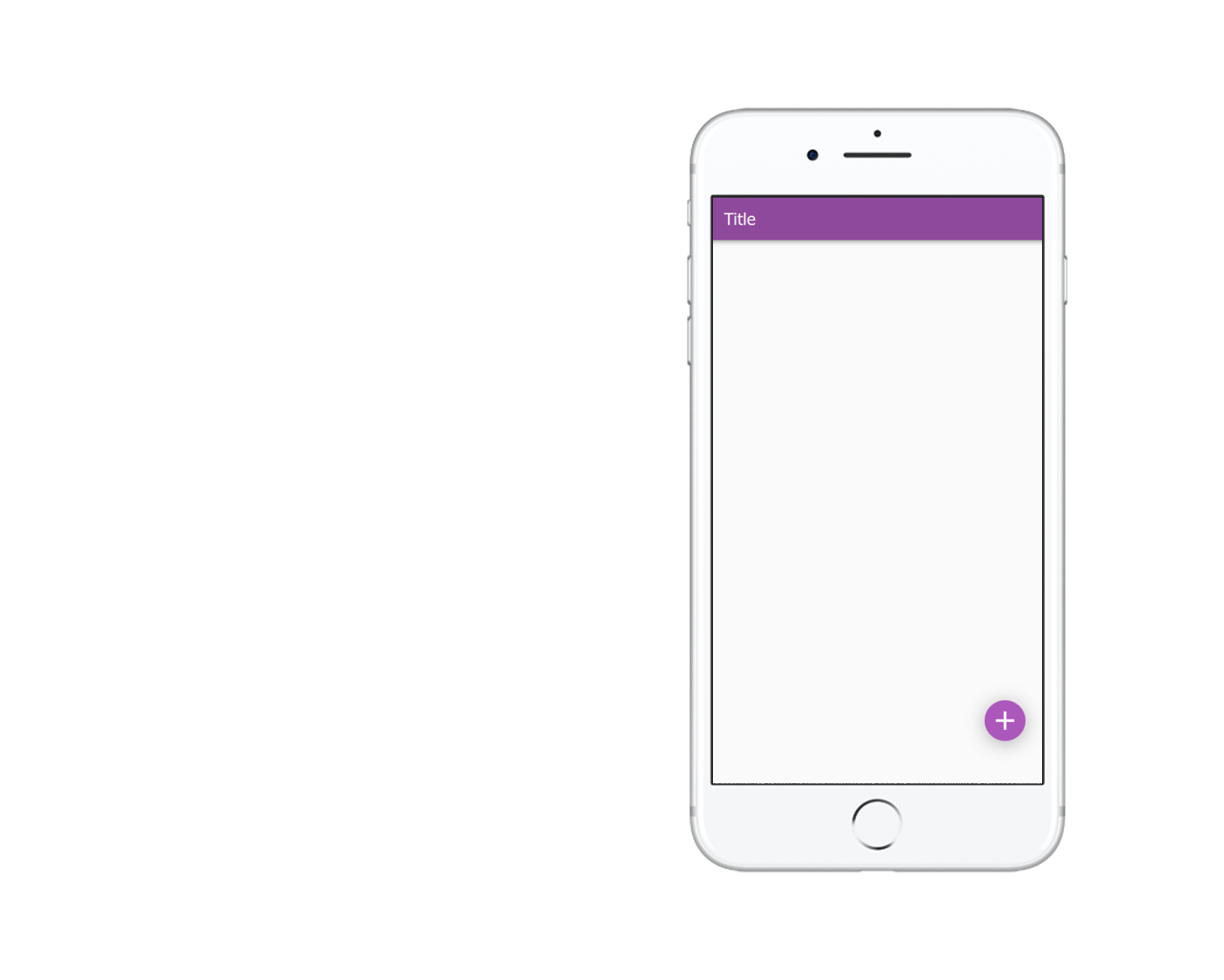

Step 2. Change primary color property.
Material primary color can be used to develop your branding color. Material accent color holds the accent of the theme, it can be same as the primary color. In this step, let’s change the primary color from "#3F51B5" to "#8f499c"
readonly property color primaryColor: "#8f499c"<SPAN class="line-numbers-rows"><SPAN></SPAN></SPAN>

Your app should look like this at this point

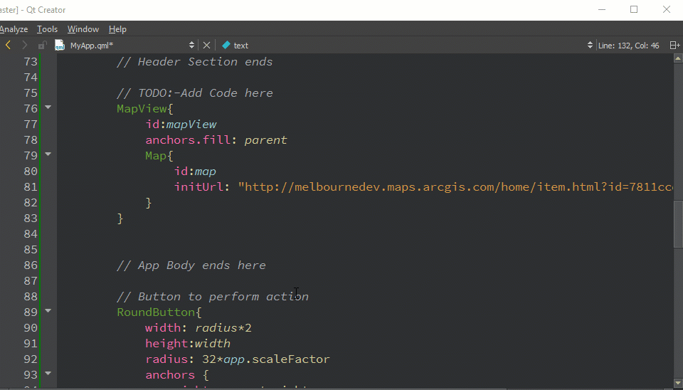

Step 4. Load a Public Web Map
In this step we will be adding a map to the app using ArcGIS Runtime. Remember that the import was added earlier in Step 1.

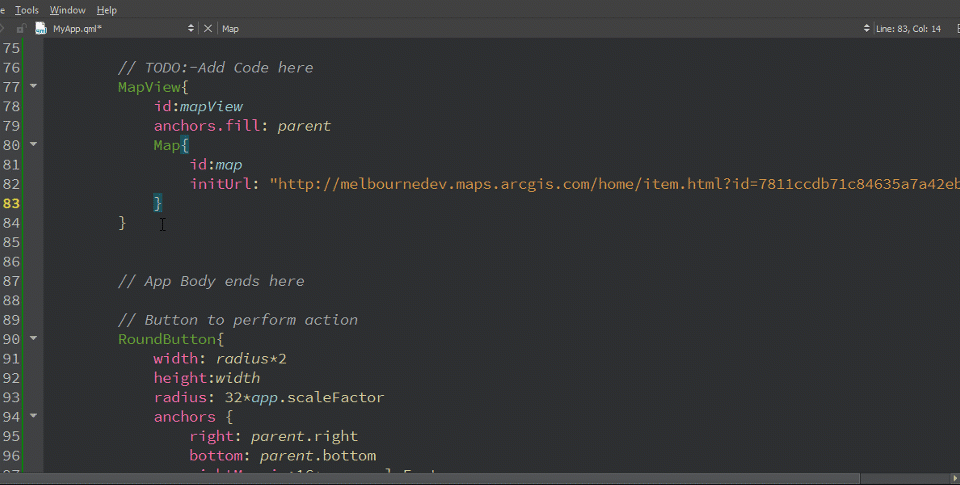

The MapView is a virtual class from the ArcGIS Runtime that renders data in a map and allows users to interact with the map. The initUrl property inside the Map QML type is used to initialize the web map. The initUrl can be item details page url, map view page url, or sharing data url.
Please add the following code below the comment // TODO:-Add Code here to the MyApp.qml file
under the comment.// TODO:-
Add Code here
Add Code here
Add Code hereto MyApp.qml file
MapView{
anchors.fill: parent
Map{
initUrl: "http://www.arcgis.com/home/item.html?id=7811ccdb71c84635a7a42eb020403615"
}<SPAN class="line-numbers-rows"><SPAN></SPAN><SPAN></SPAN><SPAN></SPAN><SPAN></SPAN><SPAN></SPAN><SPAN></SPAN><SPAN></SPAN><SPAN></SPAN></SPAN>Step 5. Add Web Map Name to the Pop-Up

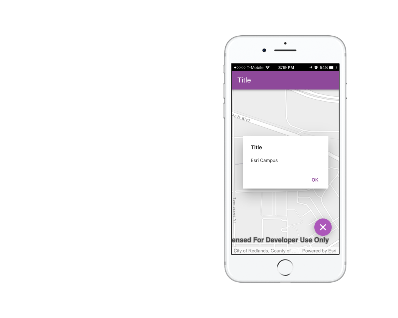

Let us replace the default text shown while clicking on the Add icon with the Web Map title. To do this, go to Dialog component and replace the Label text property with the following code. Note that the value is a property binding to the item title of the webmap as loaded by the Map (this is really awesome and so convenient. QML rocks!!!)
text: qsTr(mapView.map.item.title)<SPAN class="line-numbers-rows"><SPAN></SPAN></SPAN>

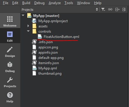

In QML, any snippet of code may become a reusable component. A file-based component is created by putting a QML element into a separate QML file. The file name is the element name and you can use the component by calling its file name. I have created a file-based reusable float action button component for Home button and Location button. The attached folder contains reusable component file FloatActionButton.qml. Once you have downloaded the attachment, you can add this file to the app project. To do this, go to AppStudio Desktop and choose the app that you are working on
- Click on the Files icon on the side panel
- Create a new folder and name it “controls”
- Copy and Paste FloatActionButton.qml file to the “controls” folder
You should be able to see this in the Qt Creator
Now that the FloatArctionButton component is added to the project, you might wonder how to use it? First of all, you need to add the import statement. After that, you can directly call the file name which is same as the component name FloatActionButton in the main file (MyApp.qml) to use the Float Action Button component.
import "controls"<SPAN class="line-numbers-rows"><SPAN></SPAN></SPAN>

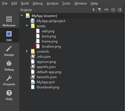

Step 7. Add Home Button and location Button Image
The next step is adding the Home button and Location button image to this project. (please find images in the attached folder) To do this,
- Go to AppStudio Desktop and choose the app that we are working on.
- Copy and paste home.png and location.png to the assets folder.
You should see this in the Qt Creator

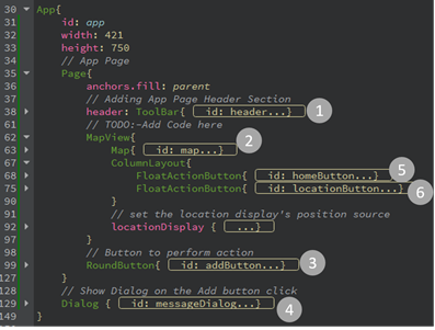

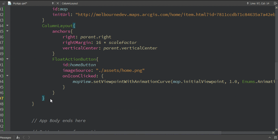

Step 8. Add Home Button
We will use a positioning elements ColumnLayout to arrange Home button and Location button by stacking them on top of each other. Let’s add the following syntax inside the MapView QML type and below the Map QML type.
ColumnLayout{
anchors{
right: parent.right
rightMargin: 16 * scaleFactor
verticalCenter: parent.verticalCenter
}<SPAN class="line-numbers-rows"><SPAN></SPAN><SPAN></SPAN><SPAN></SPAN><SPAN></SPAN><SPAN></SPAN><SPAN></SPAN><SPAN></SPAN></SPAN>
Inside the ColumnLayout QML type, let’s add the Home button by calling the Float Action Button component name FloatActionButton. Please add the following code. Note that when clicking on the Home button, we will call the setViewpointWithAnimationCurve method, it is used to return to initial Web Map extent. The first parameter of this method map.initialViewpoint sets the viewpoint, the second parameter 1.0 is the number of animation seconds, and the last parameter Enums.AnimationCurveEaseInOutCubic is a type of animation.
FloatActionButton{
imageSource: "./assets/home.png"
onIced: {
mapView.setViewpointWithAnimationCurve(map.initialViewpoint, 1.0, Enums.AnimationCurveEaseInOutCubic)
