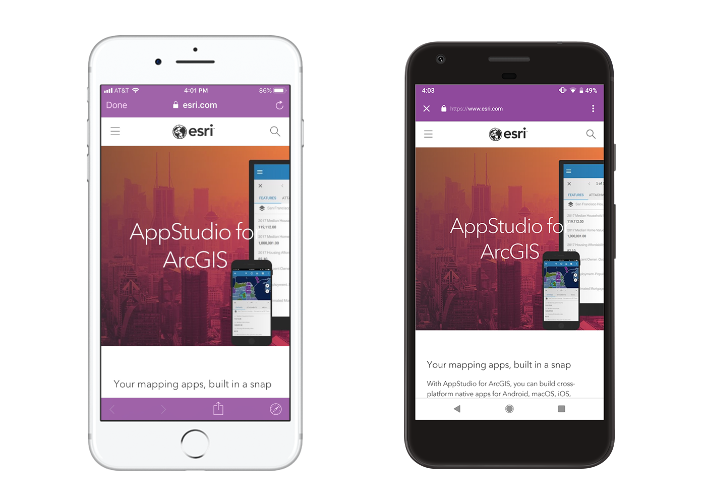

Browser View Component Enhancements:
We have introduced BrowserView component in the previous release, which brings you a full Safari web browser experience for iOS devices, we have been continuing working on BrowserView to support Chrome web browser experience for Android. Besides, you can customize the native browser view (Safari and Chrome) by changing the background and controls color with newly introduced primaryColor and forgroundColor properties in the BrowserView component. The following code snippet demonstrates how to define the BrowserView component and invoke a browser view.
import ArcGIS.AppFramework.WebView 1.0
Button {
anchors.centerIn: parent
text: qsTr("Open BrowserView")
onClicked: {
browserView.show()
BrowserView {
anchors.fill: parent
primaryColor:"#8f499c"
foregroundColor: "#f7d4f4"
url: "https://www.esri.com/en-us/arcgis/products/appstudio-for-arcgis"
<SPAN class="line-numbers-rows"><SPAN></SPAN><SPAN></SPAN><SPAN></SPAN><SPAN></SPAN><SPAN></SPAN><SPAN></SPAN><SPAN></SPAN><SPAN></SPAN><SPAN></SPAN><SPAN></SPAN><SPAN></SPAN><SPAN></SPAN><SPAN></SPAN><SPAN></SPAN><SPAN></SPAN><SPAN></SPAN><SPAN></SPAN><SPAN></SPAN></SPAN>
Browser View Sample

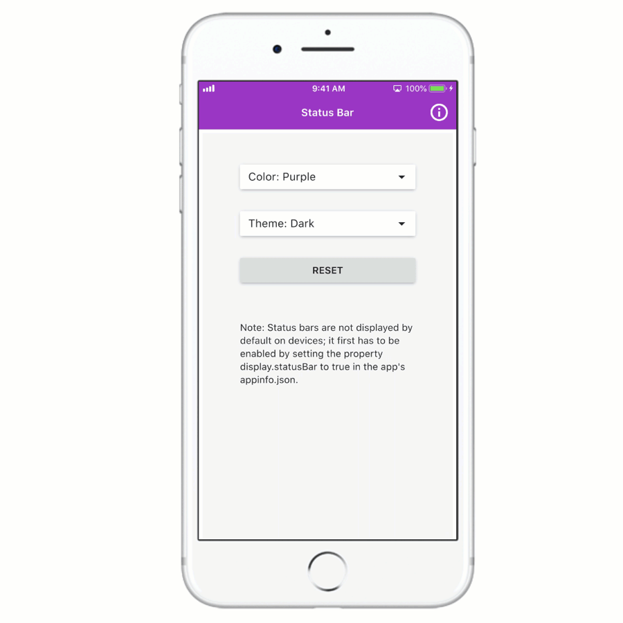

Support for changing status bar color and theme
We have introduced a new StatusBar component in ArcGIS.AppFramework.Platform plugin, which provides you access to manage the appearance of the status bar such as changing status bar color and theme color. In addition, we have also created a new AppLayout component, which can handle various heights of the status bar across devices especially devices with a notch. It should be used along with the StatusBar component. You will need to set your App object as the contents of the delegate property within an AppLayout object. The sample code below demonstrates how to use AppLayout component.
import ArcGIS.AppFramework.Platform 1.0
AppLayout {
width: 480
height: 640
delegate: App {
<SPAN class="line-numbers-rows"><SPAN></SPAN><SPAN></SPAN><SPAN></SPAN><SPAN></SPAN><SPAN></SPAN><SPAN></SPAN><SPAN></SPAN><SPAN></SPAN><SPAN></SPAN><SPAN></SPAN></SPAN>Note: Status bars are not displayed by default on these devices; it first has to be enabled by setting the property display.statusBar to true in the app's appinfo.json
Status bar sample (available on AppStudio Desktop and Player)

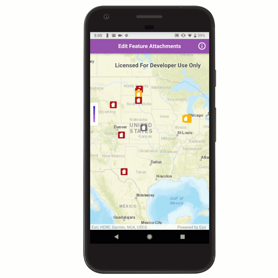

DocumentDialog component enhancements
DocumentDialog component was introduced from the last release, it allows access your device's native document picker and returns a selected file path. With AppStudio 3.3 beta, we have improved the DocumentDialog preference by adding restrictions while selecting files only available on the device's local storage.
Note: You will need to declare your app needs storage permission for Android when using DocumentDialog to access external resources and information. AppFramework provides a FileFolder component, which can invoke storage permission dialog. For example, you can include the following code into your app.
// Show storage permission pop-up on Android
FileFolder {
path: AppFramework.userHomePath }
Component.onCompleted: {
fileFolder.makeFolder()
}<SPAN class="line-numbers-rows"><SPAN></SPAN><SPAN></SPAN><SPAN></SPAN><SPAN></SPAN><SPAN></SPAN><SPAN></SPAN><SPAN></SPAN><SPAN></SPAN></SPAN>
Also, please don’t forget to enable external storage capability in the AppStudio Desktop > Settings first.
DocumentDialog Sample
We have implemented the Document Dialog feature into an existing "Edit Feature Attachments" sample app. When you try to add a new attachment, a native document picker will open, which is invoked by the DocumentDialog from AppFramework Platform plugin.
Edit Feature Attachment sample (available on AppStudio Desktop and Player)
