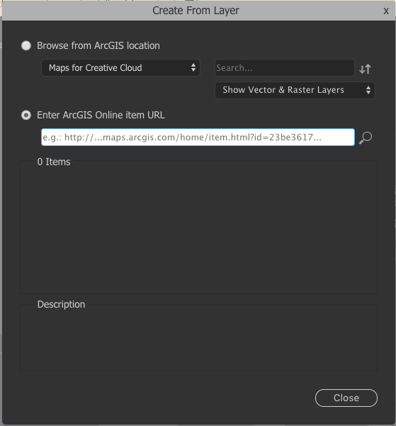

if only a small number of maps/layers you can add/reference them by ArcGIS Online item URL in the Add Map/Layer dialog:
