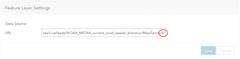

In short, in my Feature Layer item: http://www.arcgis.com/home/item.html?id=89dca88ea1d34c4d8ded02ca21e540d5 was a reference to ‘tmservices1.esri.com’, which I needed to replace with ‘livefeeds.arcgis.com’. It had the same service directory and name; just the server had changed.

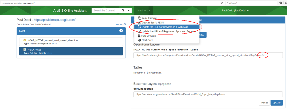

To update my map, I needed to point to the updated location of the layer. I could have done this either by re-creating my web map from scratch, and pointing to the new location, or by accessing my layer’s data service, using the AGOL Assistant by using the “Update the URLs of Services in a Web Map” as shown below.
Here is URL of one of my services: https://livefeeds.arcgis.com/arcgis/rest/services/LiveFeeds/NOAA_METAR_current_wind_speed_direction/MapServer/0

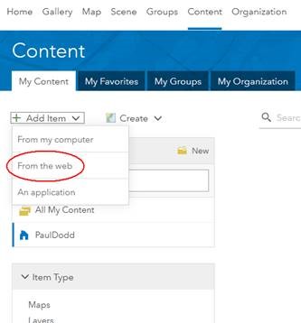

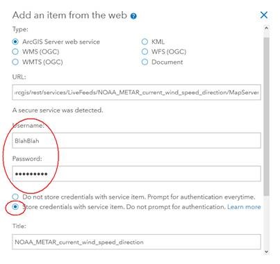

To allow users to use the map without logging in, I created a “Stored Credential” item for this layer or service under my account and then I added the resulting item to the map. In my case, the Live Feed Services require subscription access, but will not consume credits. Creating the stored credential allows anyone to access my layer by using my own ArcGIS Online credentials. Once done, I added the layer to my map, shared it publicly, and now, anyone can open my web map in ArcGIS Online without being asked to log in.

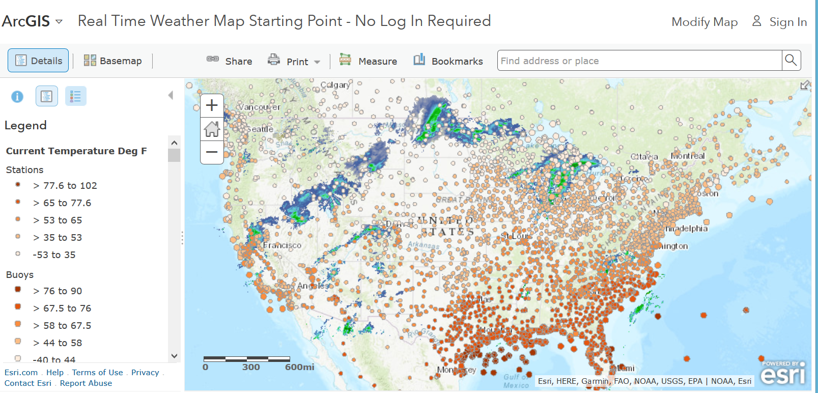

I decided to create two identical maps, one for the educator and student who just wants to work through the front half of my lesson, that did not require a log in, and one for those who want to complete the entire lesson. Once I created these two maps, I rewrote the front part of my lesson as follows:
Open and save map. Open either of the following maps that use ArcGIS Online:
- http://arcg.is/1qXXjH This is the Real Time Weather Map Starting Point that requires you to be logged in to ArcGIS Online, because it is accessing data in the Living Atlas of the World. Use this map if you wish to run through this entire exercise, including the analysis steps. After you log in, save this map in your own ArcGIS Online account’s workspace. As you work through the steps below in this exercise, save your map after each step.
- http://arcg.is/Oir1j This is the Real Time Weather Map Starting Point that does not require a log in. Use this map if you are simply doing a visual inspection of the patterns that you see on the map. You can change the style, filter the data, and perform other tasks, but you will not be able to complete the interpolation portion of this exercise with this map and without logging in to ArcGIS Online.
