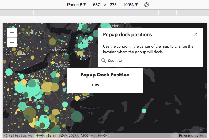

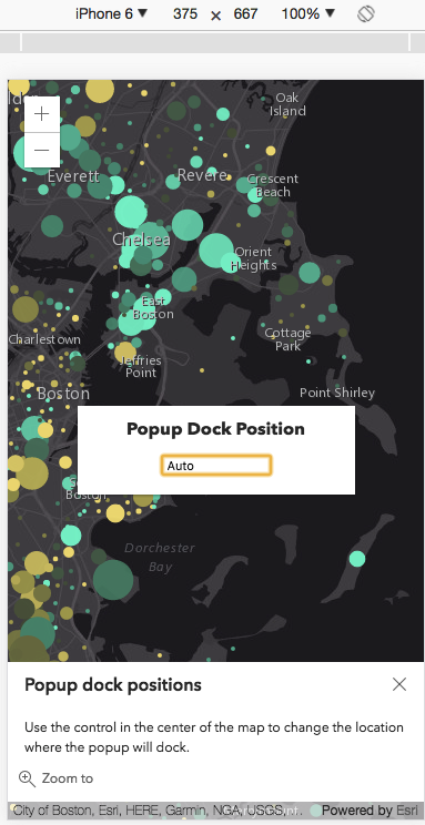

Our recommendation is to simply go play with it in a live app. A picture is worth a thousand words. Go to the Dock Positions with Popup sample, then use Device Mode in Chrome, or your favorite browser, and start playing with different configurations and orientations.
Here's a few screenshots of Chrome Device Mode approximating an iPhone 6 using the default popup settings. Note that in portrait mode, the default popup is docked on the bottom 100%, and when we rotate the phone to landscape, the popup automatically docks in the top-right position.
