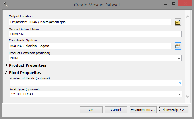

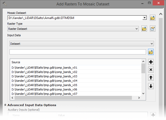

main()The next step is to create a Mosaic dataset with three bands and 32_BIT_FLOAT as Pixel Type (if this is the pixel type of the input models). To create and update Mosaic Datasets you will need a Standard license level or higher:
Once you have the empty Mosaic dataset created, you can load the composite bands into the Mosaic:

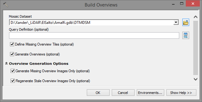

… and build the overviews:

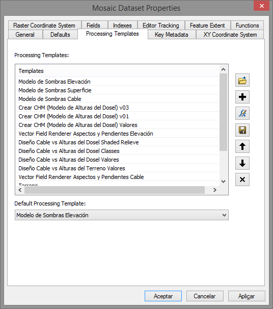

Suppose that we want to use a visualization of the Digital Terrain Model using a shaded relief as default display, we can configure this in the Mosaic.
In the Catalog window, double click on the Mosaic and activate the “Processing Templates” tab. In this case I have already configured a number of processing templates and the default processing template is set to a Shaded Relief of the elevation:
If I add the mosaic dataset to the TOC, I will display very fast and show this:

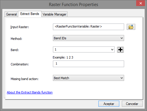

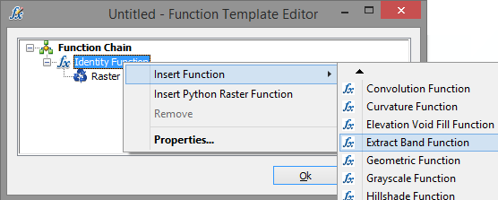

So, how can we configure the processing templates to extract the information we need? Let’s look at a very simple example. Suppose, we would like to be able to extract only the Digital Terrain Model and work with that. This can be done using the “Extract Band Function”:
And configure that it should extract the first band which in our case corresponds to the Digital Terrain Model:
… and in the General tab configure the output pixel type (in our case it is 32 bits float).

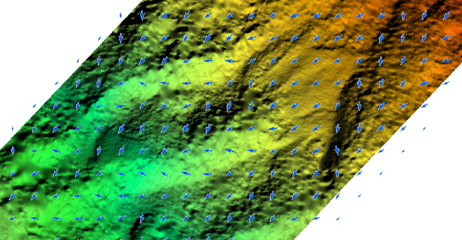

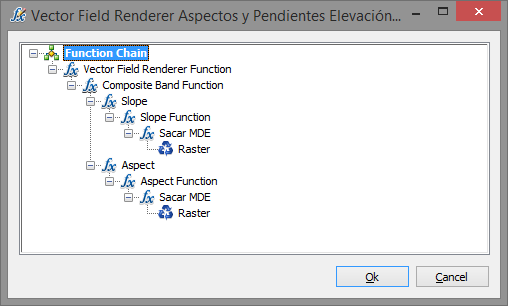

You can do all kinds of stuff with these functions like visualizing the flow of water over the surface with arrows, using vector field renderer:
Which will look like this:

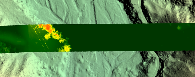

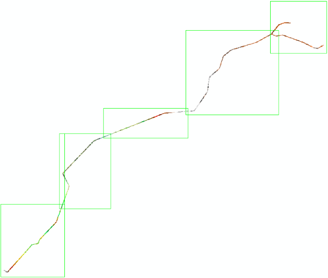

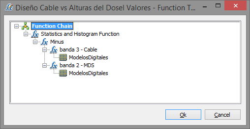

Let’s get back the topic of this post. How can we use this to validate the design of an overhead power line? For that I would need to know the distance between the cable and the Digital Surface Model. You extract band 3 (the Cable surface) and band 2 (the DSM), execute a Minus (Spatial Analyst required) and apply the Statistics and Histogram Function to enhance the output result:
This will look like this:

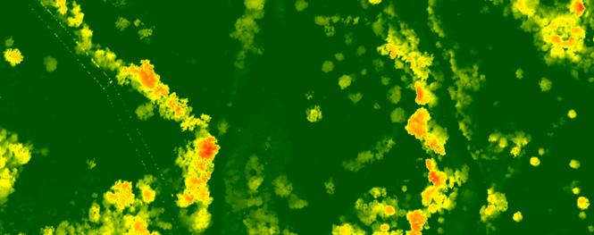

If we compare this result with the Canopy Height Model (CHM) or normalized DSM (nDSM), you will see that not all trees are near to the overhead power lines:
So, using a multiband Mosaic datasets with the DTM, DSM and cable surface enables us to publish this analytical functionality to an image service and share this in a viewer (like the Web AppBuilder) with users that don’t have access to Desktop software.
