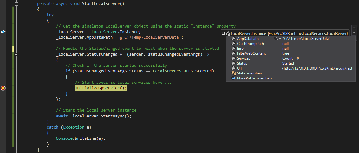

Mit dem ArcGIS Runtime SDK for .Net am Beispiel eines einfachen Buffer Tools (Download) sieht es so aus:
(a) Starten des Runtime Local Server
<SPAN class="keyword token">private</SPAN> LocalServer _localServer<SPAN class="punctuation token">;</SPAN>
<SPAN class="keyword token">private</SPAN> LocalGeoprocessingService _localGpService<SPAN class="punctuation token">;</SPAN>
<SPAN class="keyword token">private</SPAN> <SPAN class="keyword token">async</SPAN> <SPAN class="keyword token">void</SPAN> <SPAN class="token function">StartLocalServer</SPAN><SPAN class="punctuation token">(</SPAN><SPAN class="punctuation token">)</SPAN>
<SPAN class="punctuation token">{</SPAN>
<SPAN class="keyword token">try</SPAN>
<SPAN class="comment token">// Get the singleton LocalServer object using the static "Instance" property</SPAN>
_localServer <SPAN class="operator token">=</SPAN> LocalServer<SPAN class="punctuation token">.</SPAN>Instance<SPAN class="punctuation token">;</SPAN>
_localServer<SPAN class="punctuation token">.</SPAN>AppDataPath <SPAN class="operator token">=</SPAN> <SPAN class="string token">@"D:\Temp\LocalServerData"</SPAN><SPAN class="punctuation token">;</SPAN>
<SPAN class="comment token">// Handle the StatusChanged event to react when the server is started</SPAN>
_localServer<SPAN class="punctuation token">.</SPAN>StatusChanged <SPAN class="operator token">+</SPAN><SPAN class="operator token">=</SPAN> <SPAN class="punctuation token">(</SPAN>sender<SPAN class="punctuation token">,</SPAN> statusChangedEventArgs<SPAN class="punctuation token">)</SPAN> <SPAN class="operator token">=</SPAN><SPAN class="operator token">></SPAN>
<SPAN class="comment token">// Check if the server started successfully</SPAN>
<SPAN class="keyword token">if</SPAN> <SPAN class="punctuation token">(</SPAN>statusChangedEventArgs<SPAN class="punctuation token">.</SPAN>Status <SPAN class="operator token">==</SPAN> LocalServerStatus<SPAN class="punctuation token">.</SPAN>Started<SPAN class="punctuation token">)</SPAN>
<SPAN class="comment token">// Start specific local services here ...</SPAN>
<SPAN class="token function">InitializeGpService</SPAN><SPAN class="punctuation token">(</SPAN><SPAN class="punctuation token">)</SPAN><SPAN class="punctuation token">;</SPAN>
<SPAN class="punctuation token">}</SPAN>
<SPAN class="punctuation token">}</SPAN><SPAN class="punctuation token">;</SPAN>
<SPAN class="comment token">// Start the local server instance</SPAN>
<SPAN class="keyword token">await</SPAN> _localServer<SPAN class="punctuation token">.</SPAN><SPAN class="token function">StartAsync</SPAN><SPAN class="punctuation token">(</SPAN><SPAN class="punctuation token">)</SPAN><SPAN class="punctuation token">;</SPAN>
<SPAN class="keyword token">catch</SPAN> <SPAN class="punctuation token">(</SPAN><SPAN class="token class-name">Exception</SPAN> e<SPAN class="punctuation token">)</SPAN>
Console<SPAN class="punctuation token">.</SPAN><SPAN class="token function">WriteLine</SPAN><SPAN class="punctuation token">(</SPAN>e<SPAN class="punctuation token">)</SPAN><SPAN class="punctuation token">;</SPAN>

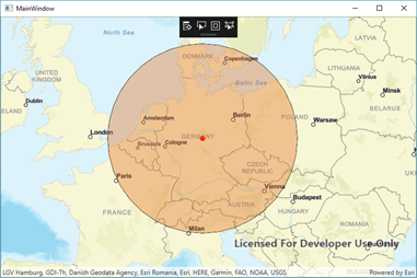

<SPAN class="keyword token">private</SPAN> <SPAN class="keyword token">async</SPAN> <SPAN class="keyword token">void</SPAN> <SPAN class="token function">MyMapViewOnGeoViewTapped</SPAN><SPAN class="punctuation token">(</SPAN><SPAN class="keyword token">object</SPAN> sender<SPAN class="punctuation token">,</SPAN> GeoViewInputEventArgs e<SPAN class="punctuation token">)</SPAN>
<SPAN class="keyword token">var</SPAN> gpUri <SPAN class="operator token">=</SPAN> <SPAN class="keyword token">new</SPAN> <SPAN class="token class-name">Uri</SPAN><SPAN class="punctuation token">(</SPAN>_localServer<SPAN class="punctuation token">.</SPAN>Services<SPAN class="punctuation token">[</SPAN><SPAN class="number token">0</SPAN><SPAN class="punctuation token">]</SPAN><SPAN class="punctuation token">.</SPAN>Url<SPAN class="punctuation token">.</SPAN>AbsoluteUri <SPAN class="operator token">+</SPAN> <SPAN class="string token">"/SimpleBuffer"</SPAN><SPAN class="punctuation token">)</SPAN><SPAN class="punctuation token">;</SPAN>
<SPAN class="comment token">// Create parameters, run the task, process results, etc.</SPAN>
<SPAN class="comment token">// ...</SPAN>
<SPAN class="keyword token">var</SPAN> geoprocessorTask <SPAN class="operator token">=</SPAN> <SPAN class="keyword token">await</SPAN> GeoprocessingTask<SPAN class="punctuation token">.</SPAN><SPAN class="token function">CreateAsync</SPAN><SPAN class="punctuation token">(</SPAN>gpUri<SPAN class="punctuation token">)</SPAN><SPAN class="punctuation token">;</SPAN>
<SPAN class="keyword token">var</SPAN> parameter <SPAN class="operator token">=</SPAN>
<SPAN class="keyword token">new</SPAN> <SPAN class="token class-name">GeoprocessingParameters</SPAN><SPAN class="punctuation token">(</SPAN>GeoprocessingExecutionType<SPAN class="punctuation token">.</SPAN>AsynchronousSubmit<SPAN class="punctuation token">)</SPAN>
OutputSpatialReference <SPAN class="operator token">=</SPAN> MyMapView<SPAN class="punctuation token">.</SPAN>SpatialReference
<SPAN class="keyword token">var</SPAN> myInputFeatures <SPAN class="operator token">=</SPAN> <SPAN class="keyword token">new</SPAN> <SPAN class="token class-name">FeatureCollectionTable</SPAN><SPAN class="punctuation token">(</SPAN><SPAN class="keyword token">new</SPAN> <SPAN class="token class-name">List</SPAN><SPAN class="operator token"><</SPAN>Field<SPAN class="operator token">></SPAN><SPAN class="punctuation token">(</SPAN><SPAN class="punctuation token">)</SPAN><SPAN class="punctuation token">,</SPAN> GeometryType<SPAN class="punctuation token">.</SPAN>Point<SPAN class="punctuation token">,</SPAN> MyMapView<SPAN class="punctuation token">.</SPAN>SpatialReference<SPAN class="punctuation token">)</SPAN><SPAN class="punctuation token">;</SPAN>
<SPAN class="comment token">// Create a new feature from the feature collection table. It will not have a coordinate location (x,y) yet</SPAN>
<SPAN class="keyword token">var</SPAN> myInputFeature <SPAN class="operator token">=</SPAN> myInputFeatures<SPAN class="punctuation token">.</SPAN><SPAN class="token function">CreateFeature</SPAN><SPAN class="punctuation token">(</SPAN><SPAN class="punctuation token">)</SPAN><SPAN class="punctuation token">;</SPAN>
<SPAN class="comment token">// Assign a physical location to the new point feature based upon where the user clicked in the map view</SPAN>
myInputFeature<SPAN class="punctuation token">.</SPAN>Geometry <SPAN class="operator token">=</SPAN> e<SPAN class="punctuation token">.</SPAN>Location<SPAN class="punctuation token">;</SPAN>
<SPAN class="comment token">// Add the new feature with (x,y) location to the feature collection table</SPAN>
<SPAN class="keyword token">await</SPAN> myInputFeatures<SPAN class="punctuation token">.</SPAN><SPAN class="token function">AddFeatureAsync</SPAN><SPAN class="punctuation token">(</SPAN>myInputFeature<SPAN class="punctuation token">)</SPAN><SPAN class="punctuation token">;</SPAN>
parameter<SPAN class="punctuation token">.</SPAN>Inputs<SPAN class="punctuation token">.</SPAN><SPAN class="token function">Add</SPAN><SPAN class="punctuation token">(</SPAN><SPAN class="string token">"InputFeatures"</SPAN><SPAN class="punctuation token">,</SPAN> <SPAN class="keyword token">new</SPAN> <SPAN class="token class-name">GeoprocessingFeatures</SPAN><SPAN class="punctuation token">(</SPAN>myInputFeatures<SPAN class="punctuation token">)</SPAN><SPAN class="punctuation token">)</SPAN><SPAN class="punctuation token">;</SPAN>
parameter<SPAN class="punctuation token">.</SPAN>Inputs<SPAN class="punctuation token">.</SPAN><SPAN class="token function">Add</SPAN><SPAN class="punctuation token">(</SPAN><SPAN class="string token">"Distance"</SPAN><SPAN class="punctuation token">,</SPAN> <SPAN class="keyword token">new</SPAN> <SPAN class="token class-name">GeoprocessingLinearUnit</SPAN><SPAN class="punctuation token">(</SPAN><SPAN class="number token">1000</SPAN><SPAN class="punctuation token">,</SPAN> GeoprocessingLinearUnits<SPAN class="punctuation token">.</SPAN>Kilometer<SPAN class="punctuation token">)</SPAN><SPAN class="punctuation token">)</SPAN><SPAN class="punctuation token">;</SPAN>
GeoprocessingJob job <SPAN class="operator token">=</SPAN> geoprocessorTask<SPAN class="punctuation token">.</SPAN><SPAN class="token function">CreateJob</SPAN><SPAN class="punctuation token">(</SPAN>parameter<SPAN class="punctuation token">)</SPAN><SPAN class="punctuation token">;</SPAN>
<SPAN class="comment token">// Execute analysis and wait for the results</SPAN>
<SPAN class="keyword token">var</SPAN> analysisResult <SPAN class="operator token">=</SPAN> <SPAN class="keyword token">await</SPAN> job<SPAN class="punctuation token">.</SPAN><SPAN class="token function">GetResultAsync</SPAN><SPAN class="punctuation token">(</SPAN><SPAN class="punctuation token">)</SPAN><SPAN class="punctuation token">;</SPAN>
<SPAN class="keyword token">var</SPAN> outputFeatures <SPAN class="operator token">=</SPAN> analysisResult<SPAN class="punctuation token">.</SPAN>Outputs<SPAN class="punctuation token">[</SPAN><SPAN class="string token">"BufferOutput"</SPAN><SPAN class="punctuation token">]</SPAN> <SPAN class="keyword token">as</SPAN> GeoprocessingFeatures<SPAN class="punctuation token">;</SPAN>
<SPAN class="keyword token">catch</SPAN> <SPAN class="punctuation token">(</SPAN><SPAN class="token class-name">TaskCanceledException</SPAN> cancelledException<SPAN class="punctuation token">)</SPAN>
<SPAN class="comment token">// This is thrown if the task is cancelled.</SPAN>
MessageBox<SPAN class="punctuation token">.</SPAN><SPAN class="token function">Show</SPAN><SPAN class="punctuation token">(</SPAN>cancelledException<SPAN class="punctuation token">.</SPAN>Message<SPAN class="punctuation token">)</SPAN><SPAN class="punctuation token">;</SPAN>
<SPAN class="keyword token">catch</SPAN> <SPAN class="punctuation token">(</SPAN><SPAN class="token class-name">Exception</SPAN> exception<SPAN class="punctuation token">)</SPAN>
MessageBox<SPAN class="punctuation token">.</SPAN><SPAN class="token function">Show</SPAN><SPAN class="punctuation token">(</SPAN>exception<SPAN class="punctuation token">.</SPAN>Message<SPAN class="punctuation token">)</SPAN><SPAN class="punctuation token">;</SPAN>
<SPAN class="line-numbers-rows"><SPAN></SPAN><SPAN></SPAN><SPAN></SPAN><SPAN></SPAN><SPAN></SPAN><SPAN></SPAN><SPAN></SPAN><SPAN></SPAN><SPAN></SPAN><SPAN></SPAN><SPAN></SPAN><SPAN></SPAN><SPAN></SPAN><SPAN></SPAN><SPAN></SPAN><SPAN></SPAN><SPAN></SPAN><SPAN></SPAN><SPAN></SPAN><SPAN></SPAN><SPAN></SPAN><SPAN></SPAN><SPAN></SPAN><SPAN></SPAN><SPAN></SPAN><SPAN></SPAN><SPAN></SPAN><SPAN></SPAN><SPAN></SPAN><SPAN></SPAN><SPAN></SPAN><SPAN></SPAN><SPAN></SPAN><SPAN></SPAN><SPAN></SPAN><SPAN></SPAN><SPAN></SPAN><SPAN></SPAN><SPAN></SPAN><SPAN></SPAN><SPAN></SPAN><SPAN></SPAN><SPAN></SPAN><SPAN></SPAN><SPAN></SPAN></SPAN>
