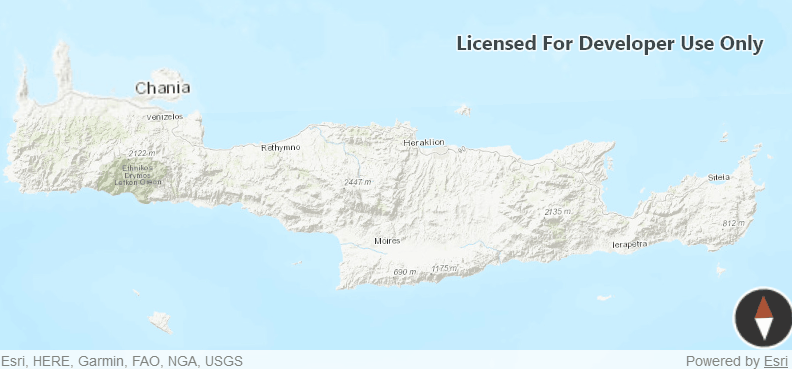

NorthArrow
The NorthArrow tool is a UI component that always points North with reference to the orientation of your SceneView/MapView.

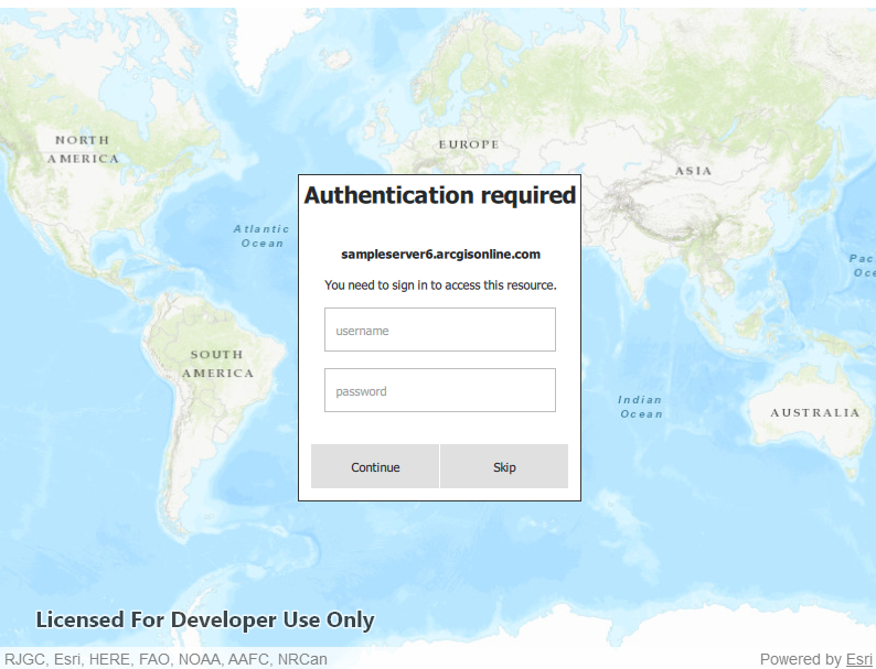

AuthenticationView
AuthenticationView provides a dialog for the user to input credentials whenever an authentication challenges is produced by ArcGISRuntime. This dialog is context sensitive and will change based on the type of challenge that is produced by ArcGIS runtime .
