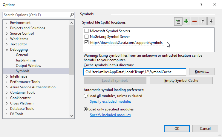

Add a reference to the Esri symbol server
- In Visual Studio, open the Options dialog (Tools > Options).
- In the Options dialog expand Debugging and choose Symbols.
- Click the ‘+’ button to add a new symbol file (.pdb) location.
- Enter the Esri symbol server URL: http://downloads2.esri.com/support/symbols.
- Ensure the checkbox is checked next to the new URL in the list of `Symbol file (.pdb) locations` and click `OK` to close the Options dialog.
For more information see Specify symbol (.pdb) and source files in the Visual Studio debugger in the Microsoft documentation.
