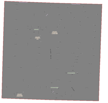

mapFrame<SPAN class="punctuation token">.</SPAN><SPAN class="token function">SetCamera</SPAN><SPAN class="punctuation token">(</SPAN>selectionEnvelope2<SPAN class="punctuation token">)</SPAN><SPAN class="punctuation token">;</SPAN><SPAN class="line-numbers-rows"><SPAN></SPAN><SPAN></SPAN><SPAN></SPAN><SPAN></SPAN><SPAN></SPAN><SPAN></SPAN><SPAN></SPAN><SPAN></SPAN><SPAN></SPAN><SPAN></SPAN><SPAN></SPAN><SPAN></SPAN><SPAN></SPAN><SPAN></SPAN><SPAN></SPAN><SPAN></SPAN><SPAN></SPAN><SPAN></SPAN><SPAN></SPAN><SPAN></SPAN><SPAN></SPAN><SPAN></SPAN></SPAN>Below is the resulting map with the feature on top. As you can see the map extent is larger than the feature shape.

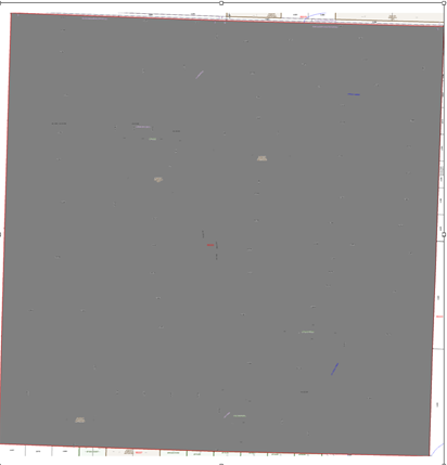

When using clip to shape in the map properties gui this is what I get. There is no data showing outside of the boundary. I need to know f there is a way to achieve this via sdk coding?
