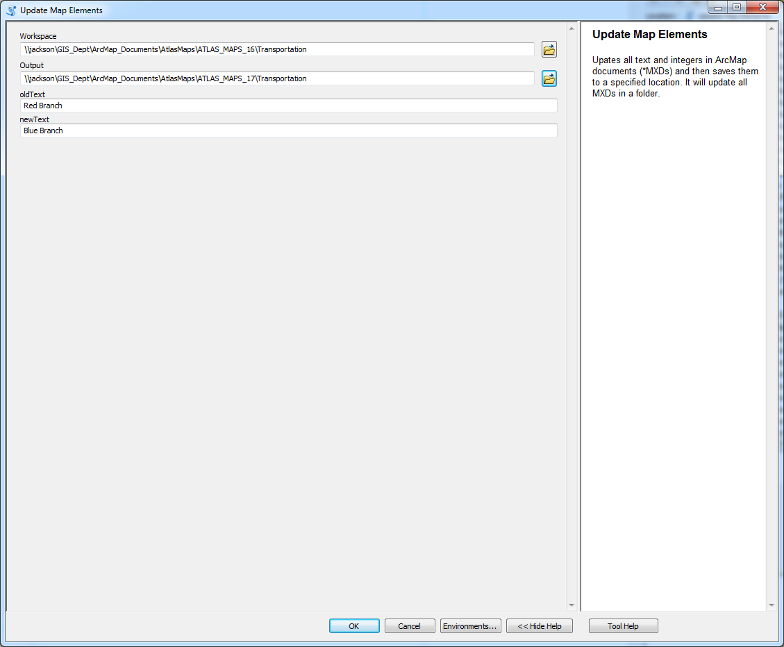

I have a working ArcMap script tool called Update Map Elements that updates text and numbers in ArcMap documents.
It has four parameters; Workspace, Output, oldText and newText. Workspace is where the input folder goes. Output is the save-to folder. OldText is the text string to be replaced by the newText text string (Red Branch changes to Blue Branch).
My problem is: how can I have multiple string values? So, in the above parameters I specify the Red Branch string value to be replaced by Blue Branch. What if I wanted to have a bunch of string values--such as Red Branch, 600, Violet (oldText) and the corresponding newText values Blue Branch, 800, Green?
I have a feeling I add index positions to the values within the script, but I'm not sure how. I've had a look at this though I'm not sure it's the right approach: SetParameterAsText—Help | ArcGIS for Desktop
