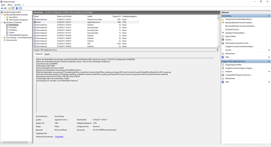

Our problem is that the app crashes randomly at the line
this.ProjectManagerViewModelInstance.CurrentMap = this.ProjectManagerViewModelInstance.OfflineMap;
with an exception we cannot handle.The output window shows:
[â¦MyApp...]WPF.vshost.exe' has exited with code -1073741819 (0xc0000005) 'Access violation'.

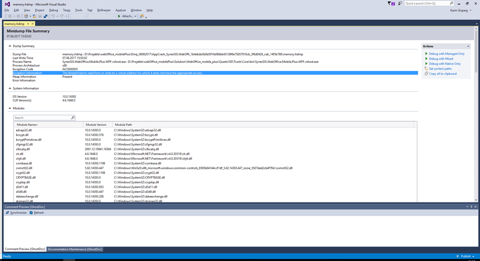

Can you help us? I attach the memory dumps, maybe it helps.
