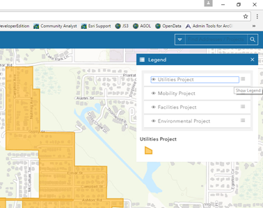

Hi - so we found a way to enable the legend to work with the layer list at 4.2 using the 'trigger-action' info from the layer list sample code. First, we set up a defineActions function to store the returns in an array of the layerLists' items:
<SPAN class="keyword token">function</SPAN> <SPAN class="token function">defineActions</SPAN><SPAN class="punctuation token">(</SPAN>event<SPAN class="punctuation token">)</SPAN> <SPAN class="punctuation token">{</SPAN>

Great job mstranovsky for setting the initial index; for handling the super-tricky layerInfo and layerInfos arrays; and for the modulus method for the changeLegend function.
Hopefully this is just a workaround until the legend is properly incorporated into the layerList widget and please feel free to add your comments
Cheers-
David
