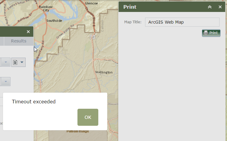

Hi,
I just noticed that our print widget has a timeout error when loading in Chrome (Version 52.0.2743.116 m). I tested a few others and found similar errors. It even happened to me when trying out Robert's Calhoun County Viewer 3.1, so I know it isn't just another poor programming error on my part . See screenshot below. The network traffic doesn't show any errors. It seems that the query to get print parameters from the service is returning a response. Anyone else having the same experience?
Sebastian,
if you would have gone to my 3.1.1 site you would not have seen the issue. Here is the thread where I provided the workaround and then esri came out with a patch:
https://community.esri.com/message/626951
Hi Robert,
Thanks for your reply. I updated the _getPrintTaskInfo function as you suggested in the post (and am using a proxy), but still get the same result. The get request is using a proxy and returns the parameters, and I don't see any errors in the console, but the widget still doesn't finish loading. If you are able, you could take a look my app at https://gis.nevcounty.net/test/wab02/index.html
Well I thought that it was issue with my change and WAB 1.3 so I added the code to my old 1.3 eSearch site that was not working in Chrome and it worked fine. So now I am trying to figure out what is different between our two site and the most obvious is the network protocol. You're using https and I am not, but that does not strike me as the issue. So I checked your code change to the Print.js and it look correct. then I found that you had already modified the Print.js for other stuff:
//Nevco Customization - added a function to process json before sending request _modifyJson: function (args) {
So I have to wonder if any of that is affecting it. I would suggest you try a vanilla print widget with the proxy change an see if it works.
