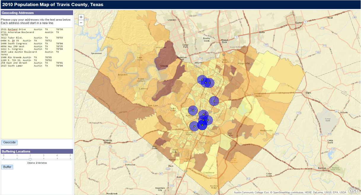

Ok so I have some working code with a geocode service in it already. Again you wont see what i have which is a map of Austin, Texas. I need to have a text area where i can place multiple addresses and then have them geocode ontop of the map when i click a button. I really just need help with this part for now. I will include two files one with the HTML code i need edited and one with HTML to be added to the other or at least somehow implemented. The result should look like this.
any help will be greatly appreciated
I have a n update to my code:

Can anyone help me. I am desperate?
Oh, ok thanks for the update. I knew i had posted in the wrong place
moved to Geoprocessing since Community Help is about getting help on the GeoNet community
another thing your candidate score will need to be >80
Sorry forgot to mention why you wont see the map. Its being done on a virtual machine, with arcgis server and adaptor. if you have either of these you might be able to see things.
