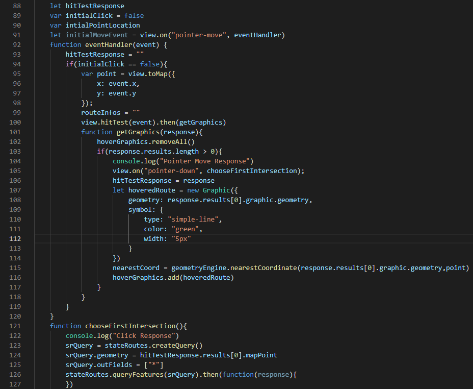

Part of the workflow is to use hit test when the mouse is moved within the view to identify which line segment they are hovering over, then zoom to that line on a click event, exposing its intersections at the same time. So far I've come up with this:
When the click event fires, though, it's showing multiple responses. Specifically, it's showing as many responses as there have been hit tests performed, cumulatively.
For instance, in the following screenshot, you see from script.js line 104, 3 instances of the hit test event firing (it prints the number of results contained in the hit test response), then 3 click responses.
Anyone know why this is happening? Code is attached.
