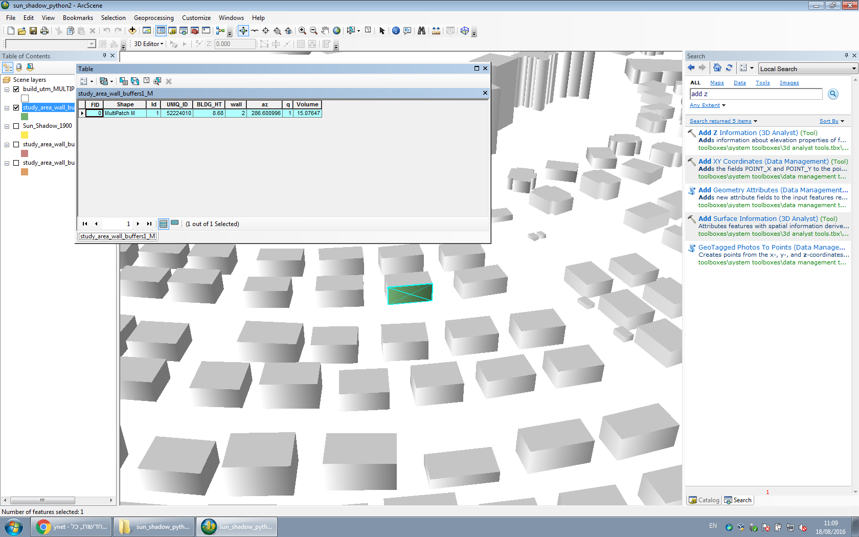

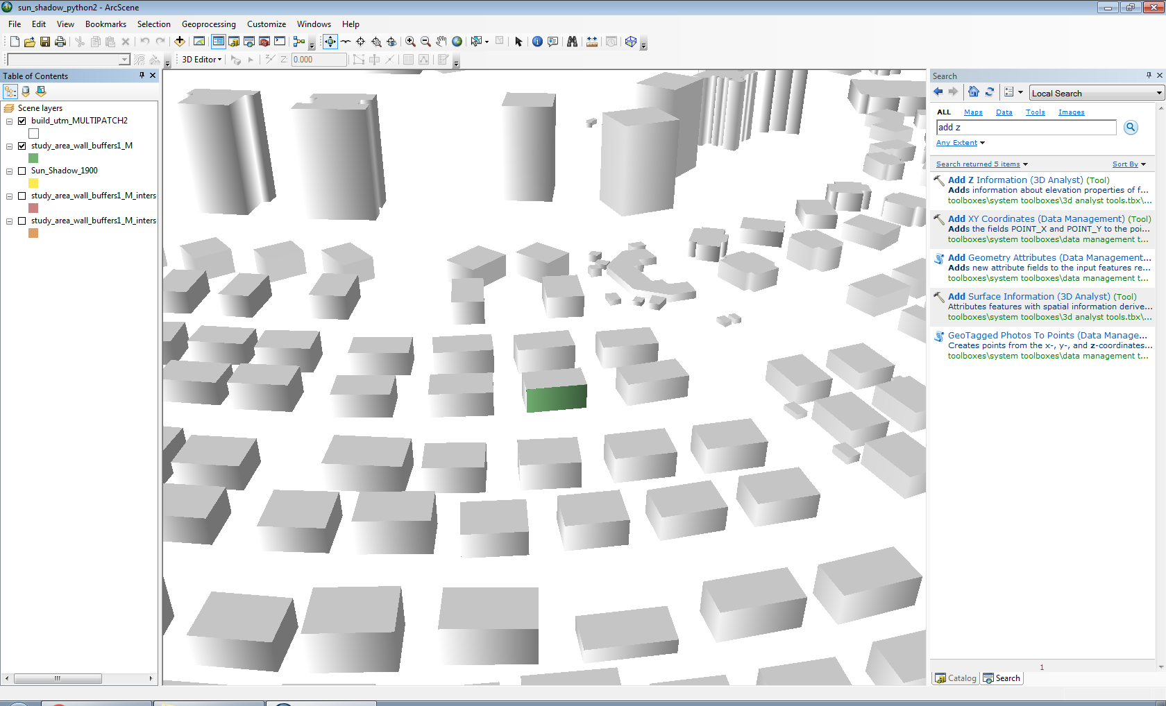

As can be seen in the following image, the initial input layers are -
1. A Multi-patch layer representing buildings in a given neighborhood (shown in grey).
2. A Multi-patch layer representing a single wall of one of the buildings (shown in green).

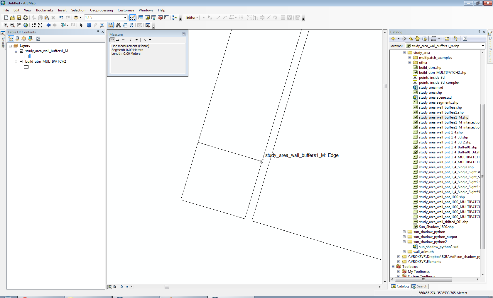

The wall is, in fact, a segment 10 cm wide, shifted 1 cm from the actual buildings, so that there is no intersection between them, as can be seen in the following "view from above" -
The intention was to find out (1) the volume of the wall, and (2) the volume of the intersection between the wall and a sun shadow multi-patch. Using these two figures the shaded fraction can then be calculated.
Wall volume (1), is equal to 15 m^3 as given using the "Add Z Information" tool -

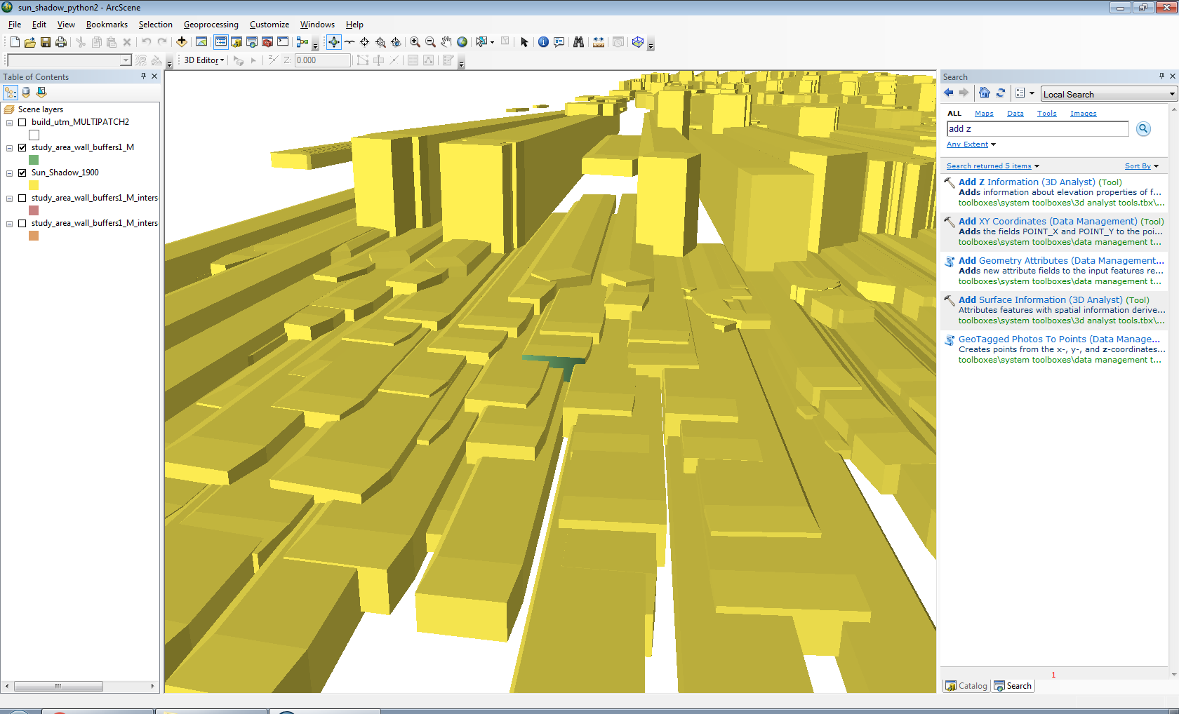

In order to obtain the shaded fraction volume, I first calculate a "Sun Shadow" multi-patch using the "Sun Shadow Volume" tool, for an arbitrary time point (today at 19:00) (shown in yellow) -

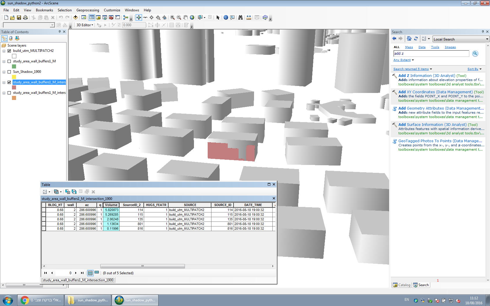

Using the "Intersect 3D" tool the shaded part of the wall is obtained (shown in red below). Visually its shape perfectly makes sense. However, examining its volume reveals that it is composed of five features, giving a total of -
5.82+5.27+2.06+1.14+0.12 = 14.41 m^3
In other words, according to the calculation 95.6% of the wall is shaded, which is clearly an overestimate.

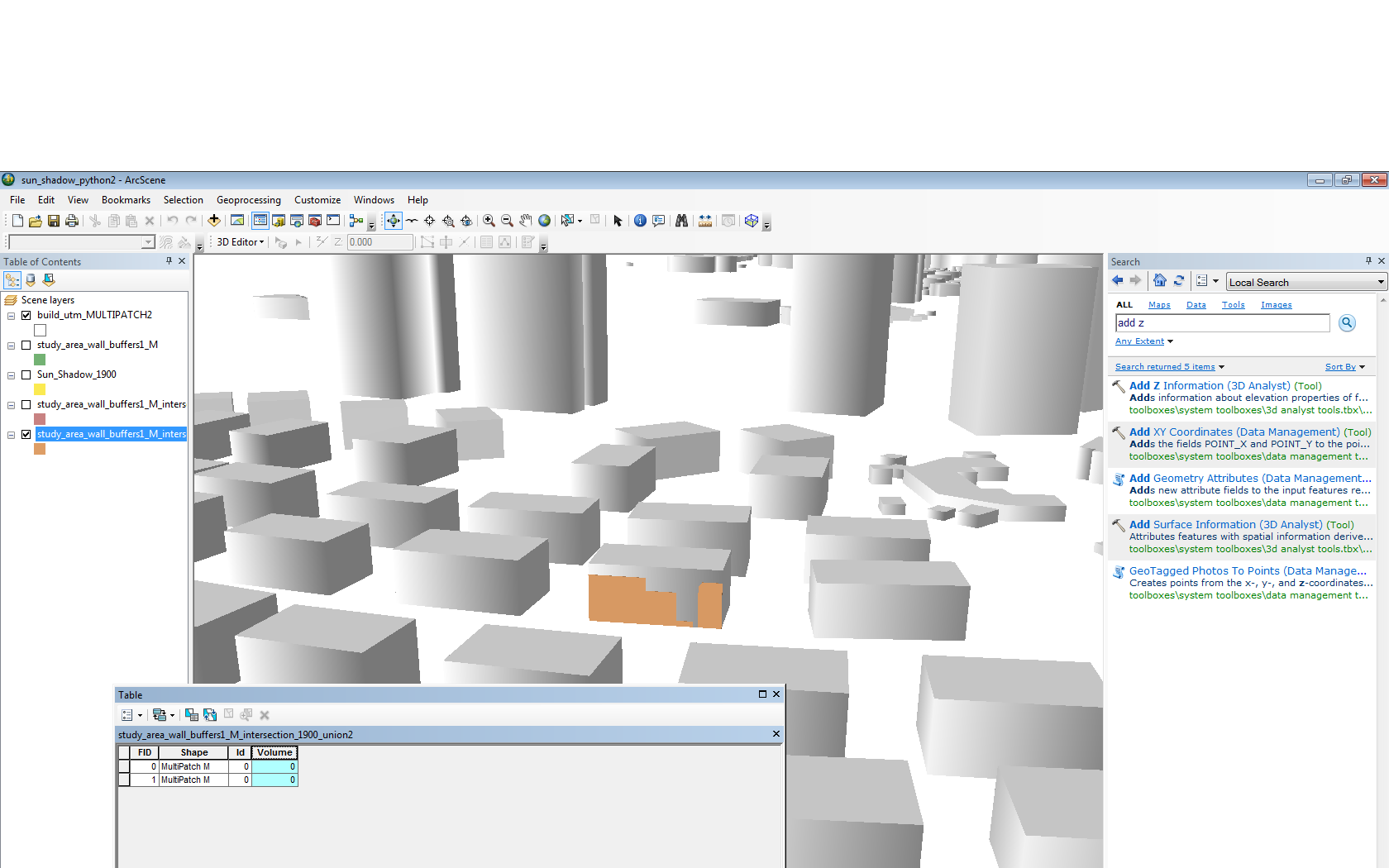

My initial thought was that the five multi-patch features are partially overlapping which leads to the overestimation. Therefore I tried dissolving them with the "Union 3D" tool. Visually the result looks the same, and indeed it was reduced to two features. However the volume is now 0 m^3 !
Does anyone have an idea what is going on?
