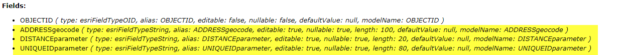

This is an example of the Feature Service Queried from ArcGIS Server to Show that the Values DO in fact exist
If I change the values in the UNIQUEIDparameter field to something like 4,5,6 and then change the Comobox to reflect those values the query WORKS. BUT when I use a longer string it fails
