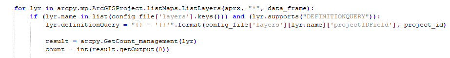

Basically I have a script that creates images from a .MXD pointed at a .GDB. Everything else seems to be working/has been converted or I already fixed but for the life of me, I can't get the ListLayers function to read layers from the newer .APRX files... I think it's something with the ArcGISProject.listMaps.ListLayers but I'd love some help/advice on howe people resolved this
CODE:
Here is where I read the layers in from the .APRX and query the ID fields.
<SPAN class="keyword token">for</SPAN> lyr <SPAN class="keyword token">in</SPAN> arcpy<SPAN class="punctuation token">.</SPAN>mp<SPAN class="punctuation token">.</SPAN>ArcGISProject<SPAN class="punctuation token">.</SPAN>listMaps<SPAN class="punctuation token">.</SPAN>ListLayers<SPAN class="punctuation token">(</SPAN>aprx<SPAN class="punctuation token">,</SPAN> <SPAN class="string token">"*"</SPAN><SPAN class="punctuation token">,</SPAN> data_frame<SPAN class="punctuation token">)</SPAN><SPAN class="punctuation token">:</SPAN>
<SPAN class="keyword token">if</SPAN> <SPAN class="punctuation token">(</SPAN>lyr<SPAN class="punctuation token">.</SPAN>name <SPAN class="keyword token">in</SPAN> list<SPAN class="punctuation token">(</SPAN>config_file<SPAN class="punctuation token">[</SPAN><SPAN class="string token">'layers'</SPAN><SPAN class="punctuation token">]</SPAN><SPAN class="punctuation token">.</SPAN>keys<SPAN class="punctuation token">(</SPAN><SPAN class="punctuation token">)</SPAN><SPAN class="punctuation token">)</SPAN><SPAN class="punctuation token">)</SPAN> <SPAN class="operator token">and</SPAN> <SPAN class="punctuation token">(</SPAN>lyr<SPAN class="punctuation token">.</SPAN>supports<SPAN class="punctuation token">(</SPAN><SPAN class="string token">"DEFINITIONQUERY"</SPAN><SPAN class="punctuation token">)</SPAN><SPAN class="punctuation token">)</SPAN><SPAN class="punctuation token">:</SPAN>

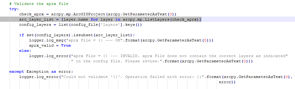

lyr<SPAN class="punctuation token">.</SPAN>definitionQuery <SPAN class="operator token">=</SPAN> <SPAN class="string token">"{} = '{}'"</SPAN><SPAN class="punctuation token">.</SPAN>format<SPAN class="punctuation token">(</SPAN>config_file<SPAN class="punctuation token">[</SPAN><SPAN class="string token">'layers'</SPAN><SPAN class="punctuation token">]</SPAN><SPAN class="punctuation token">[</SPAN>lyr<SPAN class="punctuation token">.</SPAN>name<SPAN class="punctuation token">]</SPAN><SPAN class="punctuation token">[</SPAN><SPAN class="string token">'projectIDField'</SPAN><SPAN class="punctuation token">]</SPAN><SPAN class="punctuation token">,</SPAN> project_id<SPAN class="punctuation token">)</SPAN><SPAN class="line-numbers-rows"><SPAN></SPAN><SPAN></SPAN><SPAN></SPAN></SPAN>Here is where I validate the .APRX by checking the current layers against the config file.
<SPAN class="comment token"># Validate the aprx file</SPAN>
<SPAN class="keyword token">try</SPAN><SPAN class="punctuation token">:</SPAN>
check_aprx <SPAN class="operator token">=</SPAN> arcpy<SPAN class="punctuation token">.</SPAN>mp<SPAN class="punctuation token">.</SPAN>ArcGISProject<SPAN class="punctuation token">(</SPAN>arcpy<SPAN class="punctuation token">.</SPAN>GetParameterAsText<SPAN class="punctuation token">(</SPAN><SPAN class="number token">0</SPAN><SPAN class="punctuation token">)</SPAN><SPAN class="punctuation token">)</SPAN>
arc_layer_list <SPAN class="operator token">=</SPAN> <SPAN class="punctuation token">[</SPAN>layer<SPAN class="punctuation token">.</SPAN>name <SPAN class="keyword token">for</SPAN> layer <SPAN class="keyword token">in</SPAN> arcpy<SPAN class="punctuation token">.</SPAN>mp<SPAN class="punctuation token">.</SPAN>ListLayers<SPAN class="punctuation token">(</SPAN>check_aprx<SPAN class="punctuation token">)</SPAN><SPAN class="punctuation token">]</SPAN>
config_layers <SPAN class="operator token">=</SPAN> list<SPAN class="punctuation token">(</SPAN>config_file<SPAN class="punctuation token">[</SPAN><SPAN class="string token">'layers'</SPAN><SPAN class="punctuation token">]</SPAN><SPAN class="punctuation token">.</SPAN>keys<SPAN class="punctuation token">(</SPAN><SPAN class="punctuation token">)</SPAN><SPAN class="punctuation token">)</SPAN>
<SPAN class="keyword token">if</SPAN> set<SPAN class="punctuation token">(</SPAN>config_layers<SPAN class="punctuation token">)</SPAN><SPAN class="punctuation token">.</SPAN>issubset<SPAN class="punctuation token">(</SPAN>arc_layer_list<SPAN class="punctuation token">)</SPAN><SPAN class="punctuation token">:</SPAN>
logger<SPAN class="punctuation token">.</SPAN>log_msg<SPAN class="punctuation token">(</SPAN><SPAN class="string token">"aprx File = {} --- OK"</SPAN><SPAN class="punctuation token">.</SPAN>format<SPAN class="punctuation token">(</SPAN>arcpy<SPAN class="punctuation token">.</SPAN>GetParameterAsText<SPAN class="punctuation token">(</SPAN><SPAN class="number token">0</SPAN><SPAN class="punctuation token">)</SPAN><SPAN class="punctuation token">)</SPAN><SPAN class="punctuation token">)</SPAN>
aprx_valid <SPAN class="operator token">=</SPAN> <SPAN class="token boolean">True</SPAN>
<SPAN class="keyword token">else</SPAN><SPAN class="punctuation token">:</SPAN>
logger<SPAN class="punctuation token">.</SPAN>log_error<SPAN class="punctuation token">(</SPAN><SPAN class="string token">"aprx File = {} --- INVALID. aprx File does not contain the correct layers as indicated"</SPAN>
<SPAN class="string token">" in the config file. Please review."</SPAN><SPAN class="punctuation token">.</SPAN>format<SPAN class="punctuation token">(</SPAN>arcpy<SPAN class="punctuation token">.</SPAN>GetParameterAsText<SPAN class="punctuation token">(</SPAN><SPAN class="number token">0</SPAN><SPAN class="punctuation token">)</SPAN><SPAN class="punctuation token">)</SPAN><SPAN class="punctuation token">)</SPAN><SPAN class="line-numbers-rows"><SPAN></SPAN><SPAN></SPAN><SPAN></SPAN><SPAN></SPAN><SPAN></SPAN><SPAN></SPAN><SPAN></SPAN><SPAN></SPAN><SPAN></SPAN><SPAN></SPAN><SPAN></SPAN><SPAN></SPAN></SPAN>Here is the output/ERROR:
