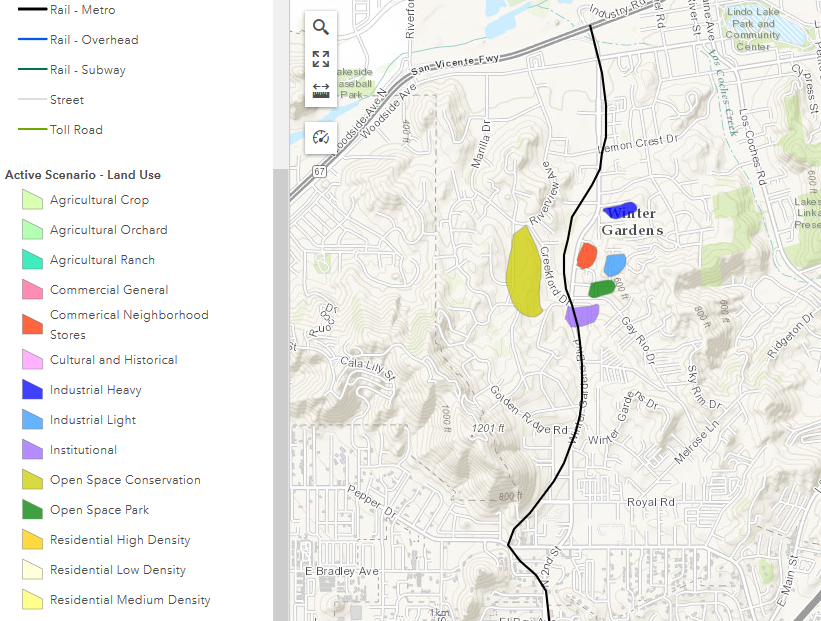

I have attached both of my scenarios (Scenario A and Scenario
Scenario A

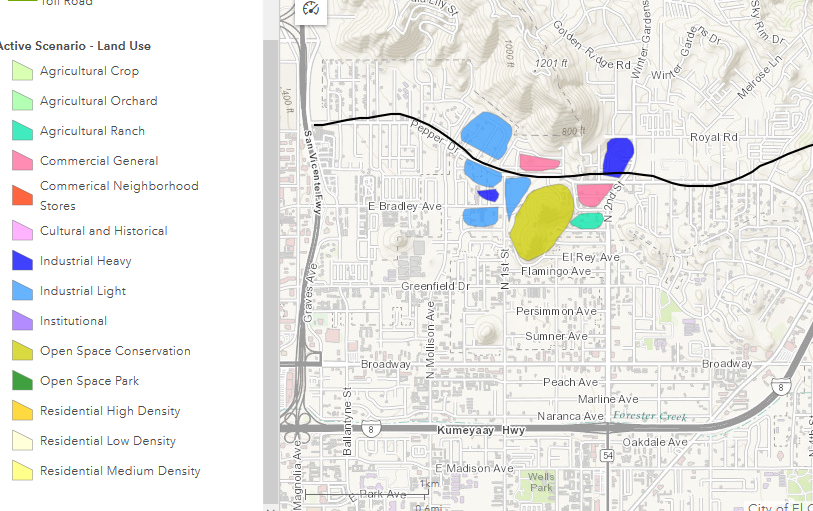

Scenario B

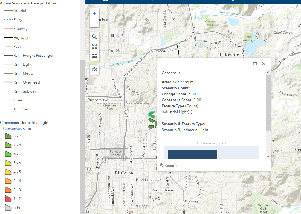

I ran a Consensus on the polygon feature layer with only Scenario B checking only Industrial Light and the output as follow

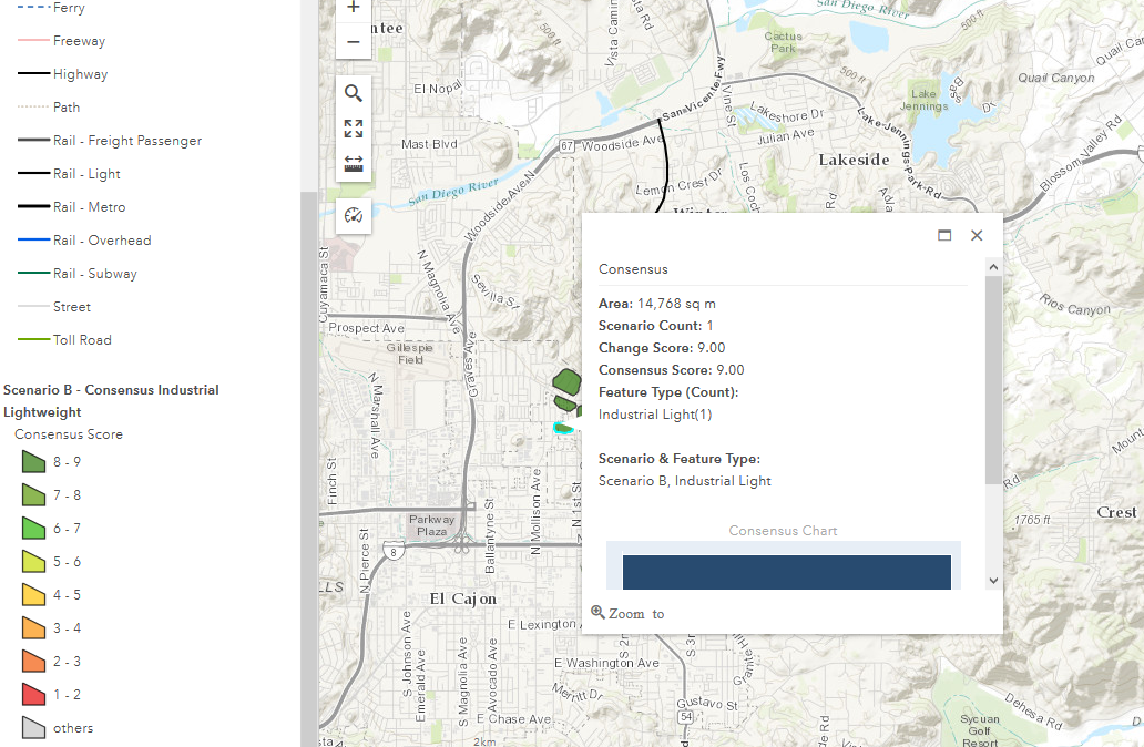

I also tried running it on both scenarios but only on Industrial Light:
