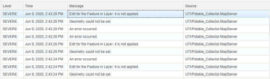

We can see the map and points just fine, but when we click "submit" we get an error. The message on the back-end looks like this:Â
Keep in mind, everyone using iPads or iPhone XR's do not have this problem. So that means it has nothing to do with the feature service, and seems to be device specific. Is there anything I'm missing here? Why would a feature service work on some devices and not others?Â
I tried comparing location settings on the devices with issues, but didn't see anything specific that was different. The GNSS coordinate system is GCS NAD 1983 2011, the map coordinate system is NAD1983 StatePlane Florida West HARN FIPS 0902 Feet.
