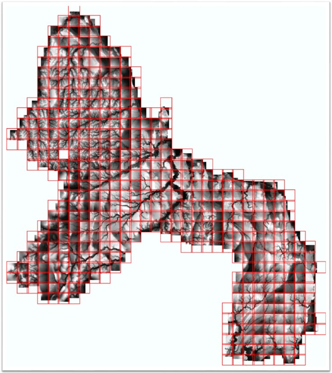

I currently still using ArcGIS 10.3 and had to generate a 1m resolution DTM for the whole of Dar es Salaam for a Flood Risk Analysis task on one of our projects. The first problem is that the source of our input data was contour shapefiles at a 1m resolution. I initially created a 5m resolution DTM from the contour datasets for preliminary results which took almost 5 days to run. This was a problem as I had to get the resolution down to 1m to run my analysis. I generated a overlapping index grid allowing for 20% overlap and sliced the contour datasets into 500 tiles. I then generated a Python module utilising Python's Multiprocessing module to process the tiles across 16 cores on our servers. The DTM tiles were completed in under 12 hrs for the entire study area. The Python module which I've attached is below, is my first draft of utilizing Python's Multiprocessing. I'm currently re-writing it now that I have a better understanding how the Multiprocessing module works.
NB: I'd like to thank Duncan Hornby for his post: Create a script tool that uses multiprocessing, that helped me create the following script
Hope the following helps anyone else trying to achieve the same for generating large DTM's
Dar es Salaam: 1m DTM Tiles
