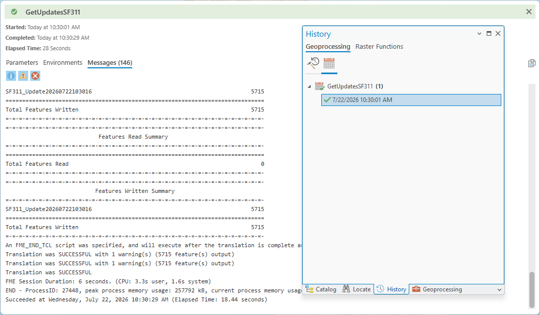

And here, after one scheduled run, we see from the History pane the latest GeoParquet file (with 2 days' worth of 311 transactions) is created in 28 seconds by the scheduled ETL tool:
Schedule History

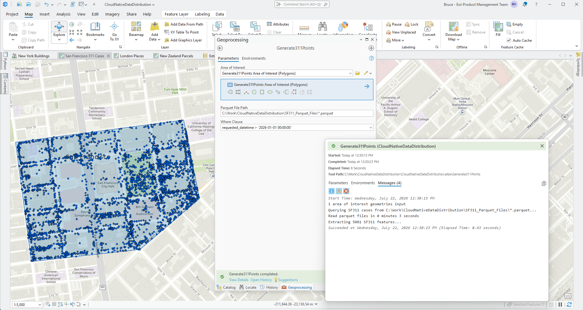

Using a script tool (see the blog download) that allows setting a query shape and where expression I extract over 5000 case features for this year around City Hall in 8 seconds.
Query Example
