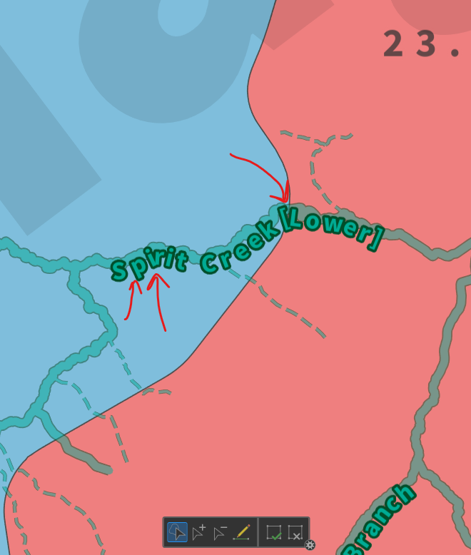

Case A (Maplex "Centered curved", ArcGIS Pro 3.1.3):
Note the areas indicated by red arrows. Maplex results in excess kerning between the "S" and "p" of "Spirit", while the "i" and "r" of the same word, and the "[" and "L" later in the label crash together in an unsightly mess. All three of those locations are cases where there's a sharper cut in the geometry of the stream centerline that the label is trying to follow. As a sidenote, the centerline geometry in question is made up exclusively of straight subsegments; there are no true/bezier curves.
As an alternative, I could select "Centered straight" for my labels, but that takes the issue too far towards the opposite end of the spectrum and often looks incredibly odd for riverine features.

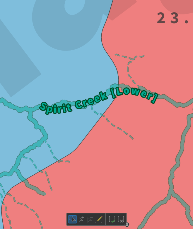

Case B (Manual):
This label was made with a text element added in the Layout view, and has only 3 vertices to control the bezier curves, and we can see that the kerning between individual characters is quite a bit better.
