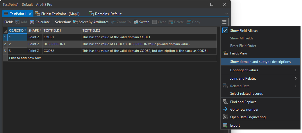

I have created an extremely basic example below (ArcGIS Pro 3.2.5) to illustrate the point. I have a point feature class with a TEXTFIELD1 that has a domain assigned. You will notice that CODE2 has the same description as CODE1. This is a slight aside to bring up the issue that you can have multiple domain codes with the same description. The user can't select both from attribute value drop-down... so it just defaults to the first one in the domain list I assume.
Anyway, the super simple domain:
The point features showing the domain description values:
The point features NOT showing domain description values:

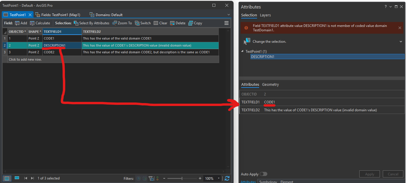

Point 2 selected - the Attributes pane correctly warns that the attribute value DESCRIPTION1 is not a valid domain value.
However, if you click the TEXTFIELD1 value pick list, and you select DESCRIPTION1, it will not update the base value to be the valid CODE1 domain value. It remains DESCRIPTION1. The only way to update the value to CODE1 is to flip the value to NULL (or some other domain value), and then choose the correct value; or, use Calculate Field and apply the CODE1 value that way.
And just to follow up on that side-note about CODE2 having the same description as CODE1 - there is no way to choose a value that resolves to CODE2.
Further, there is an inexplicably odd behavior where if 'Show domain and subtype descriptions' is off, the Attributes pane shows TEXTFIELD1 as the CODE1 value! What in the heck? What kind of sense are beginner or even intermediate users supposed to make of this?
